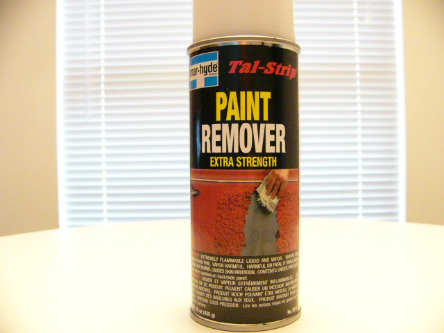

This summer, I got started working on an old tiller that I was gonna just do a little clean up on and the ol' "as long as I'm doing that, I might as well do this" got me. LOL
This thing (1966 Western Auto "Wizard" tiller made by Gilson) had three coats of paint on it and was being a real pain. I too went to the Depot and got a can of Kleen Strip. Had to use the entire can on just the handle bar section. (Brush it on, wait, remove barely 1 coat, clean and repeat the process for the other 2 coats!)
So one day while I was at the auto parts store picking up some paint, I saw some spray on paint remover by Tal-Strip and thought I'd give it a go.
Boy, am I glad I did. This stuff went through most of the 3 coats with one application, was alot easier to apply (spray on) and was only about $5 bucks a can.
You will definitely need to apply during the temperature range recommended and be sure to follow the safety tips (cover skin and use eye protection) as this stuff burns like hell when it gets on you.
Sounds like you know this from personal experience. :P

You bet! I was spraying and a breeze blew just a little misted chemical back on my forearms and in less than a minute I was like, "DANG!" Then I thought, what if this had gotten in my eyes?
So yes I like this stuff, but because it's spray on, cover your skin and WEAR EYE PROTECTION!
