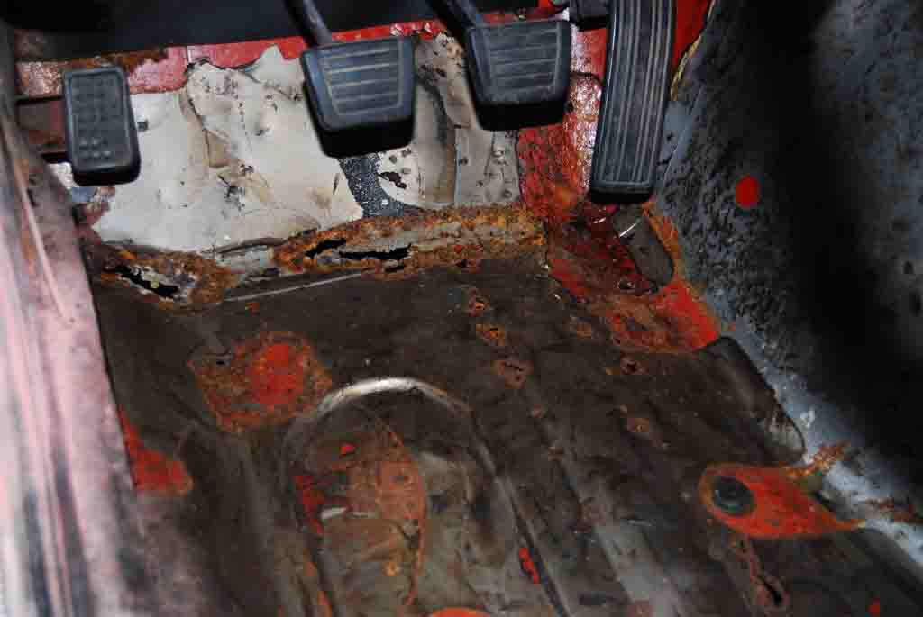

One good thing about living up north is the 15 deg days are great for removing the tar. A hammer and chisel works great. Now for the bad- It was so cold that the vinyl piece in the middle ripped while taking it out. The very bad- my floors are rusted.
If you are restoring a car right, you have to remove this tar. From underneath, my car looked great. I thought I could get by with patches. What I could not see was under the tar, which was perfectly flat when you lifted the carpet. All along the support weld, there are holes. This would have been missed had I not removed the tar.
Here's a pic of the drivers side, the other side is the same.
