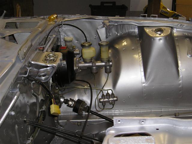

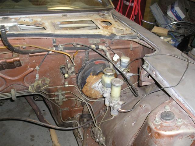

I am building a combination 70/73 240Z ( I'm using the '73 body ) . I am using the front mounted proportioning valve from the '73, but can't figure exactly how it is mounted. I know it has two holes in it, but apparently only uses one bolt. Does the other hole index on anything, to keep it straight and secure? Anyone have a good pic?

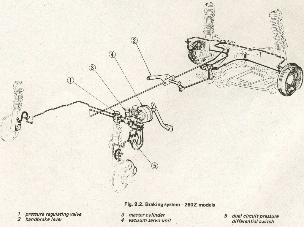

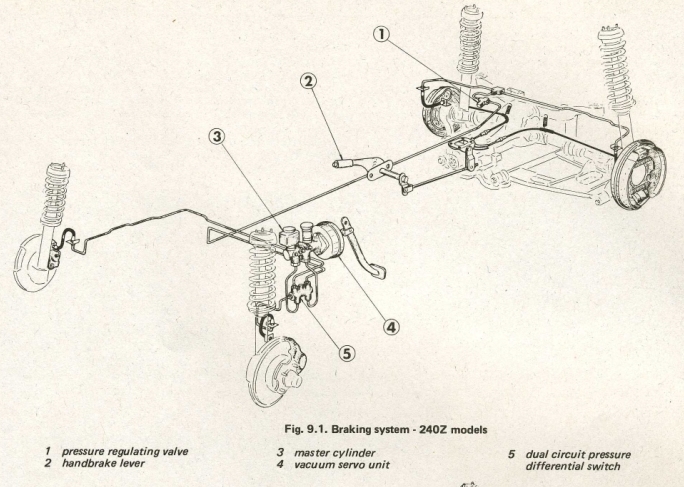

Here are a few drawings showing the location of the "Pressure Regulating Valve" and the "Dual Circuit Differential Pressure Switch" for the two different systems.
For the system with the PRV and the DCPDS located in the engine bay, Fig. 9.28. it appears that the PRV is mounted on the firewall, under the throttle linkage and adjacent the Brake Booster/Master Cylinder assembly.
It does look like it has two mounting holes doesn't it, but only one is used:ermm:
The DCPDS is mounted on the inner fender wall.
