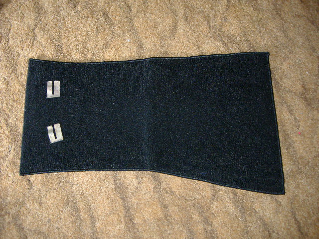

Second photo is the passenger side that DOES NOT have slits cut for the metal hold downs near the seat edge, original DOES have the slits and are edge wrapped. I will have to cut slits and edge them myself. The snaps that came with the kit will have to be installed where needed. I'll put snaps in first then cut the slits for the hold downs. Metal clips shown for reference.

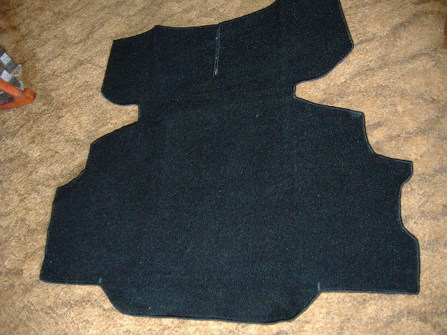

The third photo shows the new hatch area carpet and there are quite a few differences from original. The original just has slits cut (no edging) for the luggage straps near the tool boxes but near the tail lights there are slits that HAVE BEEN edge wrapped for the straps. Also the original has semi-circle cut outs that fit neatly around the fuel evaporator hoses, the new one DOES NOT. When it comes to fitment time we will see if this needs to be trimmed or it might fit without cutting and edge wrapping, I doubt as it would be all bunched up under the interior rear panel.

Thanks for the pictures and description----especially the mention of the metal carpet clips.
I have inquired about these clips with Arne and Charlie Osborne, but neither was familiar with them.
I have 2 but need 2 (or more) more. LOL
If anyone reading this has a line on them I'd appreciate it if ya'd give me a shout.
