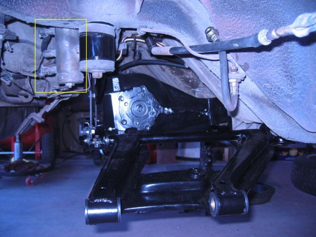

My '73 has an electric fuel pump mounted back by the tank. It is on the passenger side behind the mustache bar. It is in the yellow box in the attached photo. Check with MSA, the last time I looked in their catalog they had this part available.

The electric pump is "controlled" by the ignition circuit, so to speak. It will run when the car is running. The input side is connected to the fuel tank, the output side is connected to the fuel line that runs to the engine bay. The fuel line in the engine bay then runs into a fuel filter on the passenger side inner fender and from there to the input of the mechanical fuel pump. The output of the mechanical pump runs to the fuel rail that feeds the carbies. Then there is a fuel return line that runs back to the tank.
You may want to check and see if your Z still has the electric pump plumbed into the fuel line. If so, there is a fuel filter inside the bottom of the pump. Be sure to replace it. You may also want to replace the filter on the inner fire wall.
