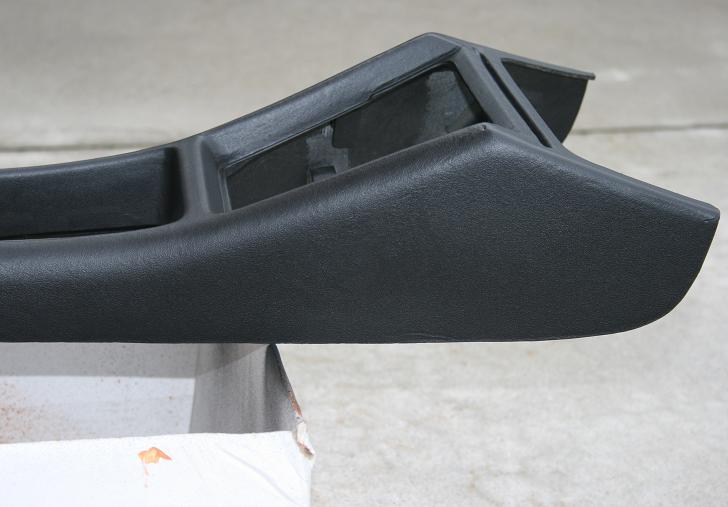

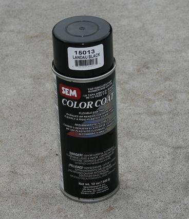

Use SEM paint. I would reccomend cleaning real well then 3M scotch pad and even priming with plastic adhesion promoter. The promoter will help the finish stick and be much more durable. I get these items from the local auto paint supply.
BTW, get satin!!!
I used the SEM Laundau Black to paint my center console and am very happy with the results. I also used the same SEM paint to do the centercaps on some original "D" style hubcaps. That thread is here:

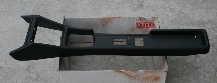

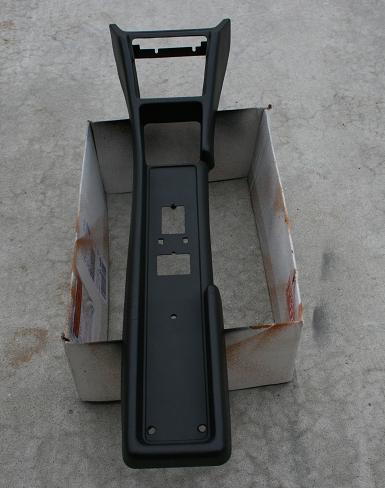

Be aware, the SEM paint I used will give a texture. I had to do this because I had filled and sanded the console. If you just want a refresh, it might not be the best choice. Since one of the original posts was about filling and repair, I thought this germane to the discussions.

SEM works great. Just use nice light thin coats. That is the key to a quality finish. It is better to do 4 very thin light coats than 1 or 2 thick ones. Let each coat dry for 15 minutes or so before the next. This is reffered to as letting them tack up first
I use the pints/quarts and spray through a auto paint HVLP gun. Never tried the spray can. Amazing results!!!!!

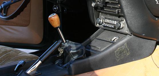

Here's a picture of a part that I did a while back. It was in several pieces at the start. JB Weld, some clamps, and a bit of patience preparing the parts to "mate" was all that it took. There are two or three coats of Fusion on this. One good coat would have worked had it not been for the repair work that I did. It's hard to tell that this was in pieces at one time, but a bit more prep work would have given me better results. I had a post or two a while back about the repair if you wish more information about how it was done.

I don't think the issue is my application. I think the material I am using is designed to provide some texture. I used it on the dash and got the same result.
All materials I have used it on, both plastic and metal are sanded, then degreased with prep-sol and then cleaned with SEM plastic prep, so they are clean. The garage is heated and at 70 degrees and finally, I am pretty sure I shook the can. Application is 3 wet semi-wet coats...no drips or runs.
I really think the material is designed to have a some texture since it is used to repaint bumpers and trim parts. Regardless, I really like it the way it is and I think it looks good, but if you are looking to "re-paint" it is maybe not the right product.
