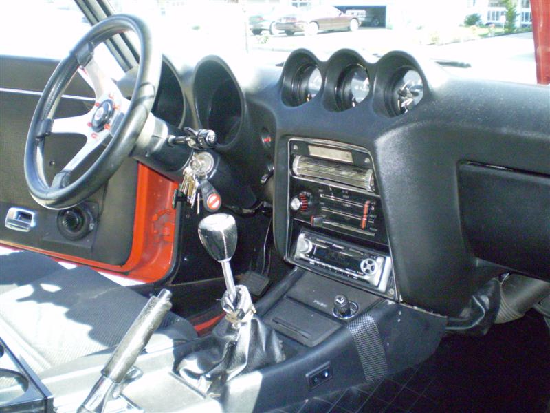

If you plan on installing an aftermarket radio into a 240Z, none of the stock wires really matter except the one from the ignition (accessory position). Run a wire from a solid constant (white/red stripe on ignition)

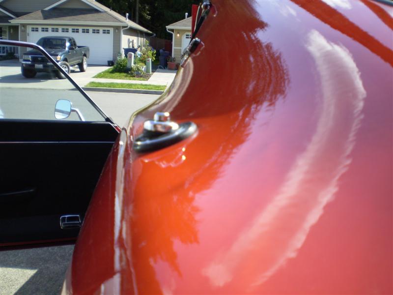

The antenna switch will not fit next to a DIN sized radio (DIN = 2" x 7") it'll work with a 2 pole radio. Picture below will show that here's no room for the stock antenna switch. There are aftermarket antenna's available that work great in the stock location. The Metra PW-22 fits beautifully, I have one. Pictured below. Just hook up the blue antenna wire to the blue wire on the PW-22 and it works great.
