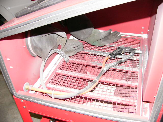

...snip...The air hose for the gun and the siphon for the abrasive come from opposite corners of the cabinet. Makes it hard to aim the gun in some directions...snip...
I was frustrated with that same problem. I solved it by increasing the length of both the air supply and siphon hoses, adding springs over the hoses at kink points and zip-tying it all together. Problem solved! :love:
