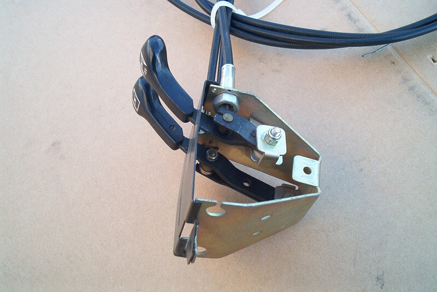

Pictures didn't make it. Let's try that again.
Marty

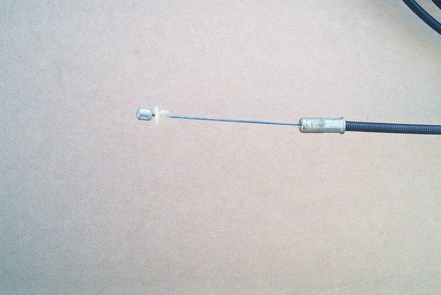

The most critical part of the Hand Throttle is that washer visible in the last picture Marty posted. That is what allows the accelerator pedal to operate under normal foot operation, and still allow the cable from the Hand Throttle to slide through the Clevis. The washer actually snaps into the clevis.
As far as length, if yours has been cut such that your cable doesn't have an end, then just have it cut to the length you need, and only leave as much cable outside the sheath as required for the travel in the lever. You could probably go to a Bicycle or motorcycle shop and get what you need to repair it.

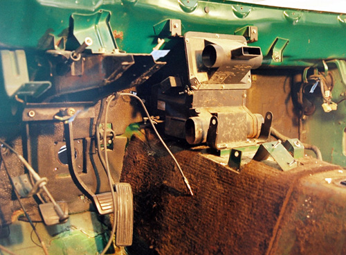

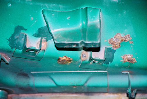

Filipe, I did not get a chance to answer your PM so I will do it here. My parts are wrapped up in the shop on the other side of town and I dont' get there very often. You will probably get cable measurements faster from this thread before I get out to the shop. I have a couple of pictures from taking 26th apart that will help, though. THe first is the firewall with the dash removed and the pedal cluster still in place. THe next is a close-up of the firewall with the pedal cluster removed. You can see the cable hanger in the lower right part of the picture. This hanger is peculiar to chassis fitted with the hand throttle originally. Of course, we have had the conversation about the wisdom of the hand throttle and how they were removed very soon after the HLS30 was imported into America. We had a conversation about the reference to the hand throttle being covered up in the early owner manuals.
You all might get a kick out of the close-up picture. You can see a couple of rust spots I had to take care of. But notice the dark green painted areas around some of the other brackets. Evidently, after 26th was painted, spot welds around the pedal cluster brackets were added and then covered up by hand paint. Also, inside the bracket there is no paint. Just primer and some bare metal with surface rust. I still have to take 27th apart, so I am anxious to see if there is something similar lurking beneath the dash.

Chris' (26th-Z) second picture shows the cable hold bracket that I, incorrectly, referred to as being part of the dash frame.

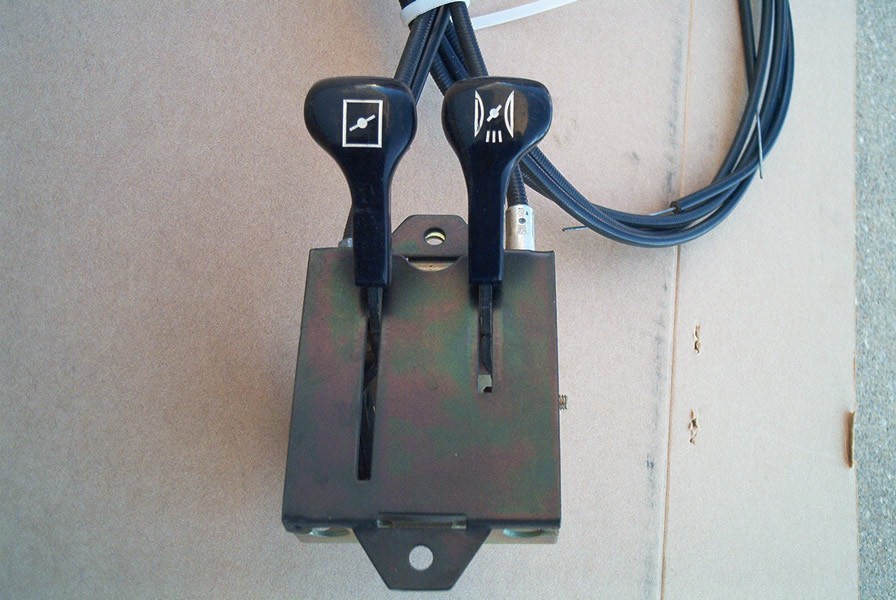

Secondly, if you look at the first picture Marty posted, you'll see that the original Choke cable bracket is already fitted for the Hand Throttle. You can either use the shorter length lever or a Choke lever but on the right hand side pivot. The second shows the differences in the travel allowed to the Hand Throttle vs the Choke.
