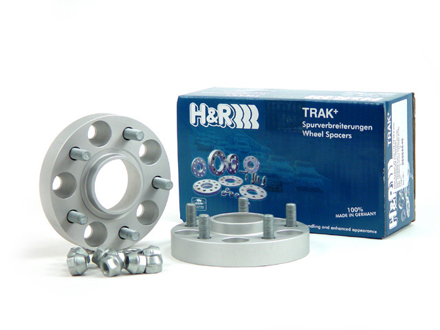

For the amount of offset change you will need, spacers are simple. They will bolt to the hub, and the wheels will bolt to the spacers. Not much to it. Most spacers of this type will be at most 25mm (1 inch) thick, and so they will reduce the offset by 25mm.
This picture is five lug, but otherwise the same.
