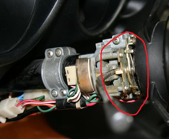

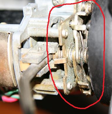

I took the cover off and began my investigation, it looks like the brass piece is the issue.
When I turn the wheel the two small post that actually cancel the signal after you turn are just barely hitting the brass piece..(sorry, I don't know what that piece is called) I pulled both small clips out of the way (theses are the pieces that the post actually push down) and it didn't click....but I don't see anyway to adjust it.
Arne, it may be the cancelling cam you refered to, is that the brass piece?
Like Arne said, time for a good cleaning and lubing. I don't know what's all over the pivot arms but they look dirty. Lube all the pivoting areas and squirt a little on the springs as well.
Sounds like a little maintanence will fix ya right up. When they stop working or start giving ya trouble, give me a buzz.
