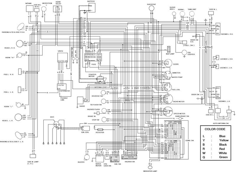

Anyone out there have a diagram of the early series 1 dash wire harness, from 10/69 to 1/70? Enrique (Escanlon) was kind enough to supply me with many wire diagrams but they were for later years. I am going through the repair process of my harness and would love a diagram to assist in the cause.
Thanks,
Stephen

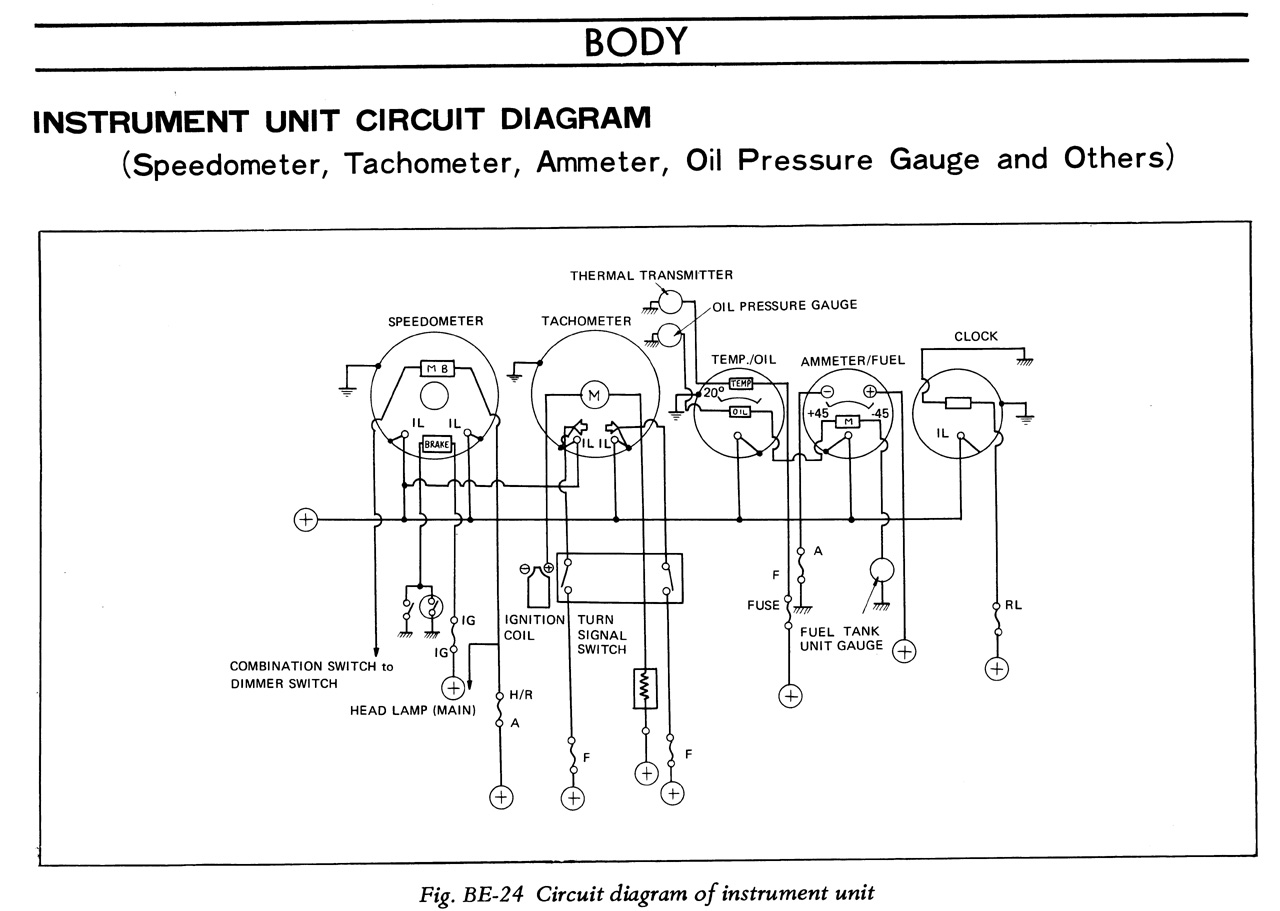

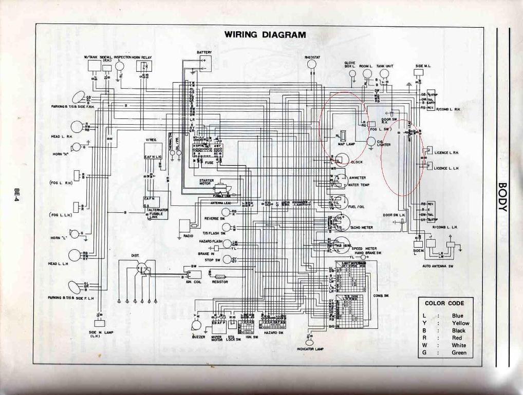

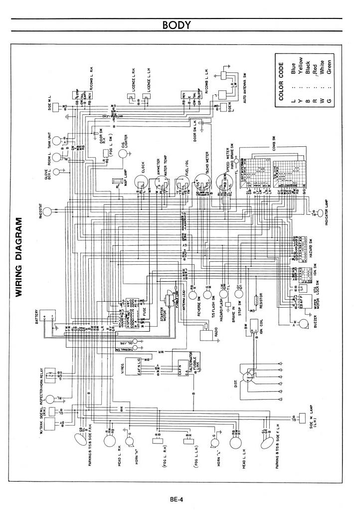

You might give this a try, WIRING DIAGRAMS Nissan Z - ZX
1970-1988 1 through 59
www.V8-240Z.com/Files/Datsun/Wiring-Diagrams/70-88 Z Wiring.htm
There is also some diagrams in the other link below
www.V8-240Z.com/Files/Datsun/Wiring/
If you want to D/L the entire wiring diagram data base as it shows in the top link grab the Wiring-Diagrams.zip file or the self extracting Wiring-Diagrams.exe from the link below.
