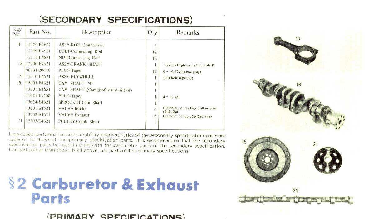

My previous motor was similar but with maximum size pistons and completely worn out. I decided to stay with the specification because of the interesting crank with the 8 bolt flywheel (see picture).

I am curious about the potential crank problems. Does anyone know anything about the after market crank that I have (see picture in the original post) is it also susceptible to failure?
