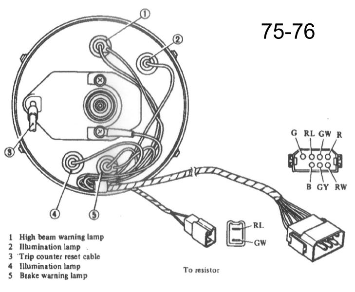

I you have a 75, you want a speedometer from a 75-76. A 77-78 speedometer has an extra pin in the connector when compared to a 75-76 speedo and a 75-76 speedo has an extra connector for the resistor so they aren't interchangable. Basically, two plugs-early, one plug-late. Compare these scans:

Thanks for the tech info. I had found one out of a 78 and thought it would be the same. I'm glad I didn't get it.
