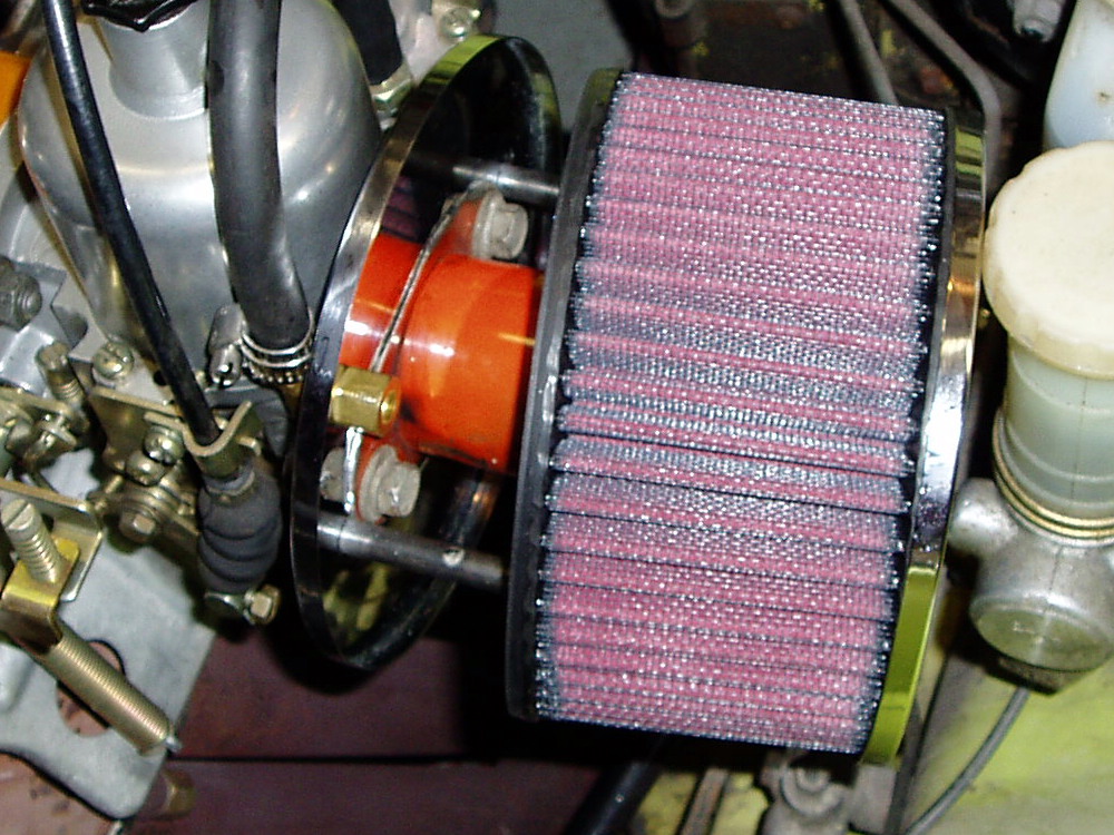

hey carl beck, i rigged my SU's to have the airhorns. i wanted to keep the venturis after watching the ZTherapy video.
After looking at a photo Alan sent me of a 432 air cleaner, I though about doming the area across from and concentric to the horns while retaining the removeability of the assembly, I just haven't done the math to figure the proper doming.
Will
My setup. I ran it by Z Therapy and they said it would work well. Uses the TWM air horns sold by MSA as well. FWIW my cars AC compressor gets in the way of the stock air box so the previous owner modded the air cleaner.
