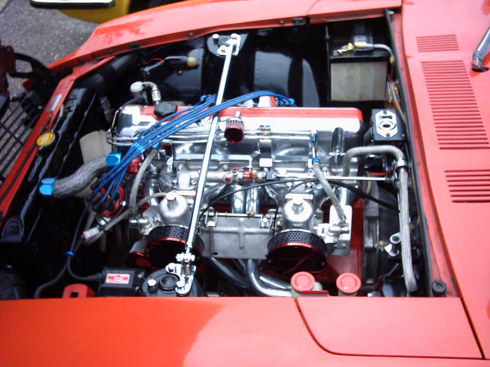

On the tranni, I washed it down first using a degreaser, then I used a 6" wire wheel on my buffer (hand held) and rand it all over the tranni to give it that shiny "Cast" look. Turned out pretty decent. No painting, polishing, plating and or dissasembly needed. You can barely see the tranni in the pic but it looked great when it was first done.

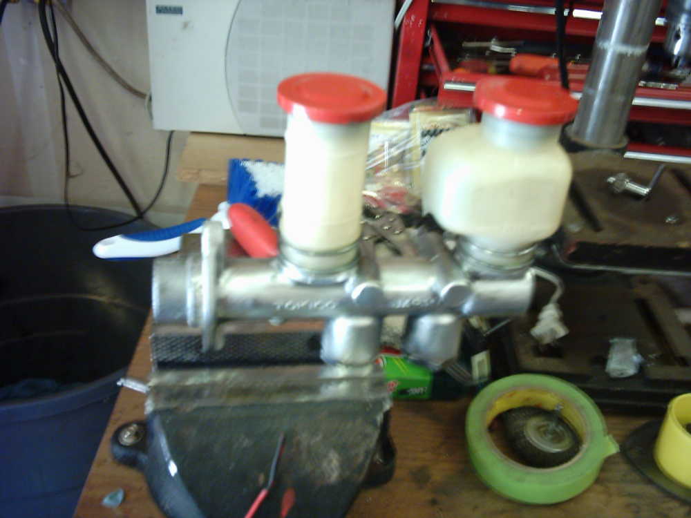

I also did the same thing on the master cylinder. 6" on the 1/2 horse bench top.
