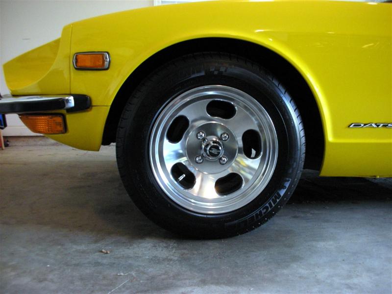

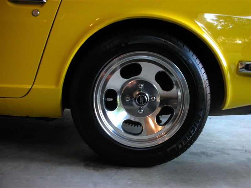

I have a 1973 240z with a rear height 1/2inch lower than stock level and the front height 1.5inch lower than stock level due to suspension mods. I installed 15" rims and that are 7.5" wide and would suggest not exceeding this 7.5
" width. I mounted BF Goodrich 205/60/15 g-Force Sport tires and they are a good balance for handling and ride. Just be sure to keep them properly inflated since the 240z car is so light (roughly 750-800lbs load per wheel). BFG recommended to me keeping them inflated at 24-25psi COLD pressure.
