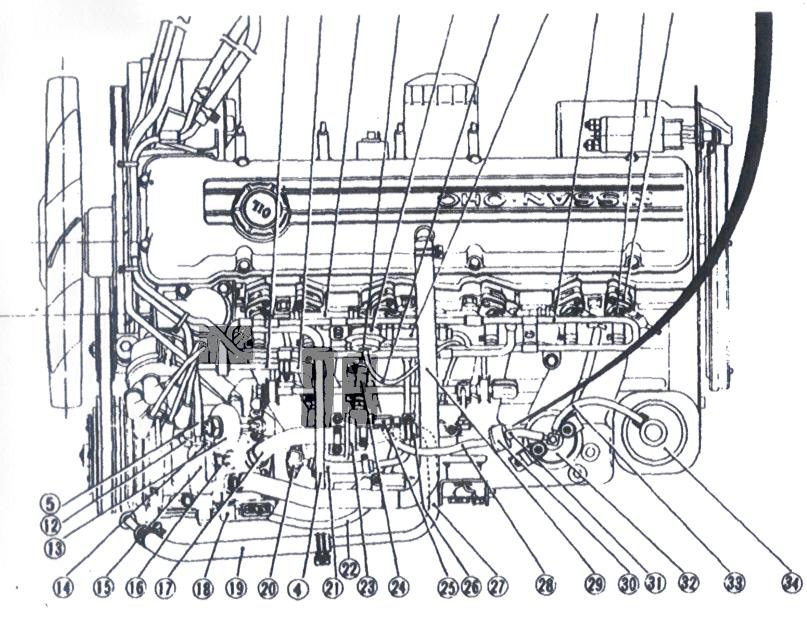

Also fuel filter, brake fluid and hoses. The 3 little heater hoses in the middle of the fuel injection. Probably want to clean all the injector clips, cold start valve, thermotine and temp sense clips.
Not even sure what these are but bet I can find them. Just a good inspection and cleaning?
Mike
