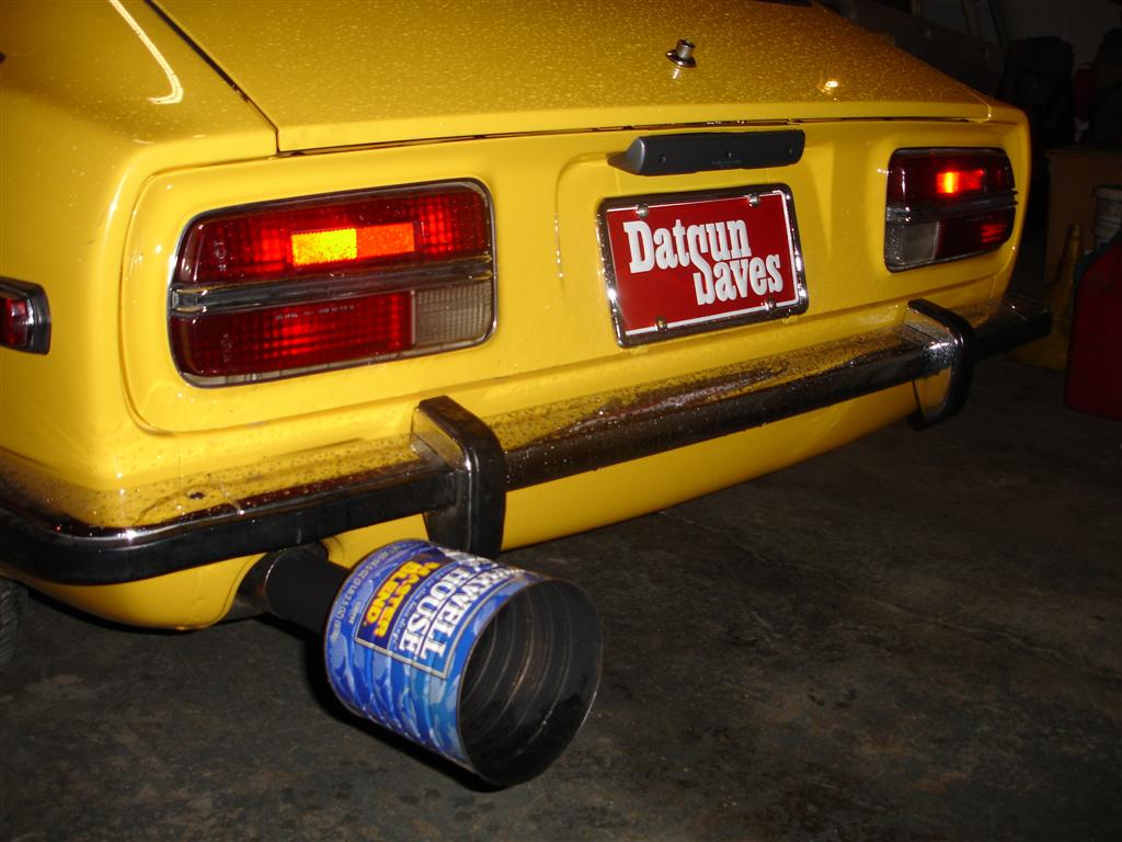

The chrome extensions on your twin tailpipes - look like they are only screwed on - and they are open in the back. So it is possible that some of the exhaust gases are being let out behind the chrome extensions.. between the chrome extensions and the actual tail pipe.
Take the chrome tips off - and show me a picture of where the actual tail pipes end.
There are "muffler sealers" that most muffler shops have on hand - they are about like modeling clay.. or plumbers putty. Try sealing the back of the chrome extensions to the tail pipe inside them.. and see if that helps.

Yes, they are just screwed on as I was just experimenting with different lengths.
Here is a picture of the original setup with the extensions off and a few pictures showing just how far I took them out.
Any thoughts?

I took this morning off and went down to a friends muffler shop to try and tackle my fume issues. I took the extensions off the old setup and didn't bother putting the older tips back on since I was just going down the street and would be yanking this old muffler off.
Here's the really weird part....during the drive to the shop with both windows down I didn't have that much exhaust fumes, just a barely detectable smell when rolling to a stop. The only thing that changed was the exhaust outlets didn't have the original tips on, and ended almost under the car.....So to make sure it wasn't a fluke I put the original extensions back on which went about an inch past the bumper, and then swapped for the longer extensions and drove around............Both drives had the exhaust smell...:eek:.. Take off all extensions and no smell, it's crazy.
So, we hack off the old muffler and just before we put an original type back on the owner says we need to try this Magnaflow, his speculation was that with the bigger mouth and keeping it shorter it may produce the same results, if not we will go back to the original style and go 1 to 1 1/2 inches past the bumper.
I take it for a 3 mile drive and NO SMELL....and it sounds so much better than the stock, I love it.....except for the fact that a million teenagers also have this setup..I feel like a street racer :devious: LOL.
I don't think it looks that bad, and with no cabin fumes I am thrilled.
My old Orange 240 was pretty much bone stock, and I am a true fan of keeping things original, but I figure this is a small price to pay for getting rid of that smell. (plus it goes well with the Panasports)
FYI...total cost parts and labor...$218.00
