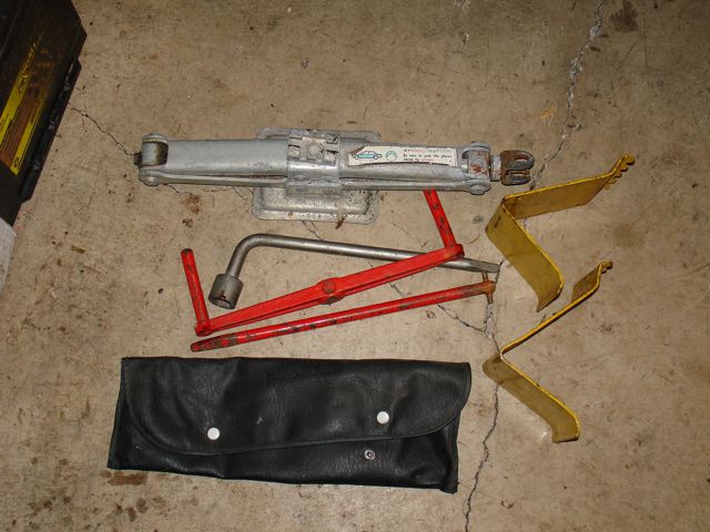

Original tools, also from a '71. Note the scissor-type jack. Originally came with four spare lug nuts, too.
SWEET! Thanks Arne! The jack and tools are there. Looks like the wheel chocks have never even been used! There are no lug nuts, but there are 4 plastic tubes (about 3" long x 3/4" diameter). 3 black and one red. No clue what these would have been for (hold the lug nuts maybe).
