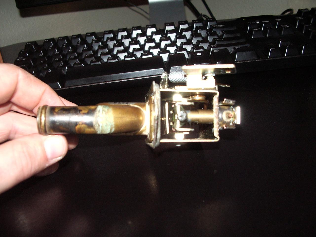

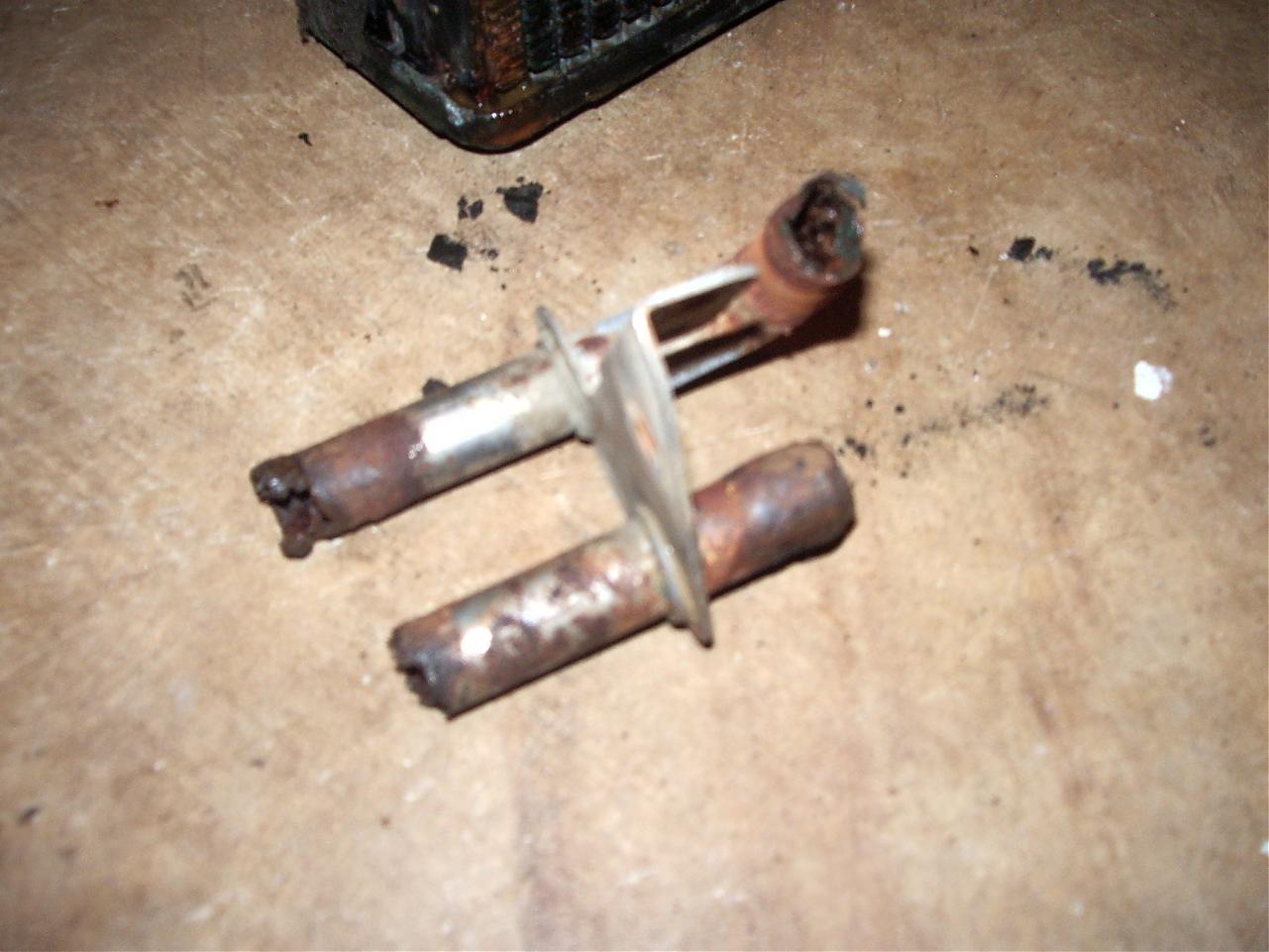

The Nissan part number is 27190-N3100 (ASSY-CONNECTOR-WATER) From Aug. 73. I bought one a few years back. Not expensive, it was under $12 from the dealer. Hopefully, they're still available. Did your heater core come with a new heater vavle? You might want to change that too while you're in there as well as all adjacent hoses and clamps. I did.

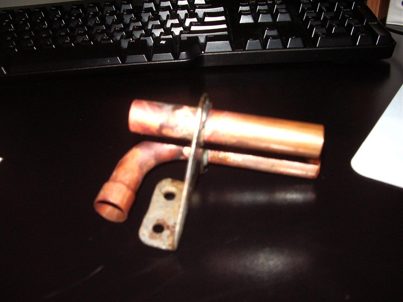

Well guys I called everywhere including junk yards around here and nobody had it. I called nissan and they stopped making them a few years ago so I had a guy downtown fab one for me... cost me 30 bucks....but at lest it will work for me.:D

You need it. From what I recall you'll either have heat all the time or never depending on where the setting was when the capillary tube broke. Problem is, I don't know where to suggest to get one. Took me a couple of months to find one. But I wasn't going to settle for a used one or put the old one back in after putting all that work into the heater. And there are two kinds. One for cars with factory ac and one for cars w/o factory ac. They are not interchangable.
