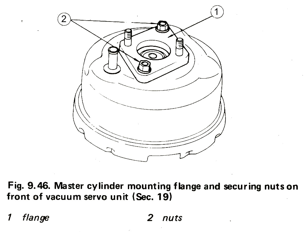

There is supposed to be a 10mm flange between the Booster can and the Master Cylinder.
It converts the horizontal studs on the booster to vertical studs to mount the M/C.

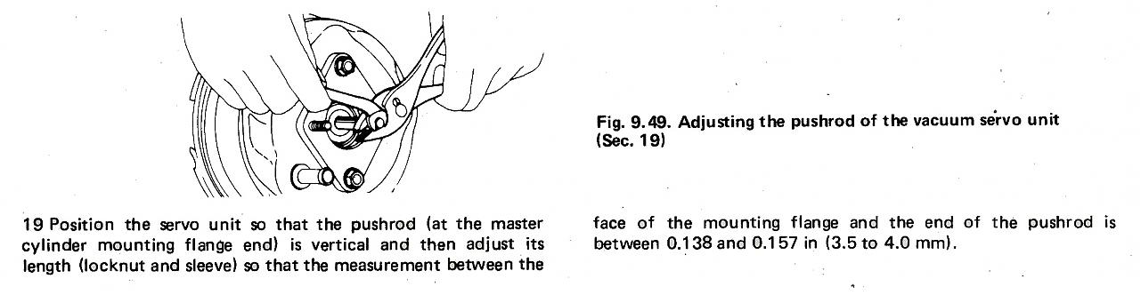

According to the Haynes Manual, the booster pushrod is adjustable in length.
If you doing all that and there is still a 10mm gap, all is pear shaped:finger::finger:
Your concern is noted beandip, thanks! And thanks a lot to you nissanman! i had thought about a spacer but figured it would be easier to just cut the m/c pushrod. But hey, a spacer(flange) is the original one so i`ll just go for that. The Z we have was previously owned by my kid brother who couldnt find a booster/m.c.(not common this part of the world), so he put whatever could fit(which didnt have a spacer, i didnt know that some cars used em, ignorant me). Now off to the machine shop for the spacer.
Not really as the vertical studs pass through it. It's just a spacer. One should have come with the booster you ordered. I guess they expected you to use the one off your old booster. (Which it didn't have) You car should actually have a 6" booster unless it's a 73. 73 and up had a 7.5" booster and the 2+2 had a 9" booster. There is no 8" booster that I know of.
