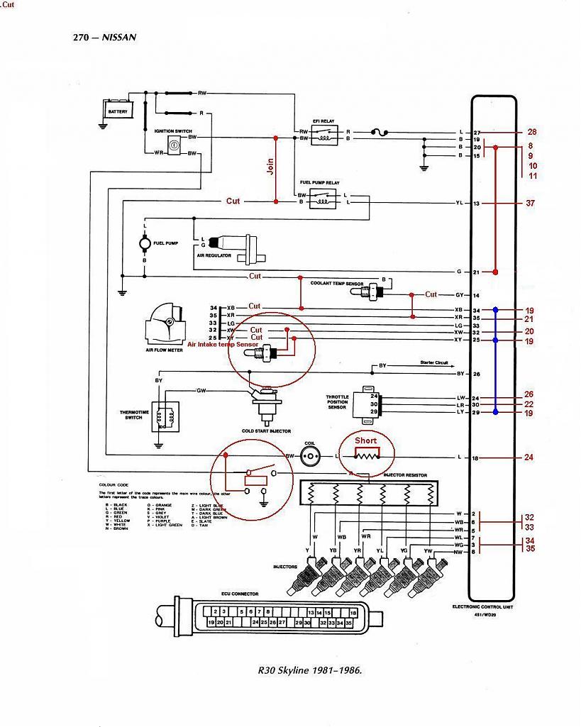

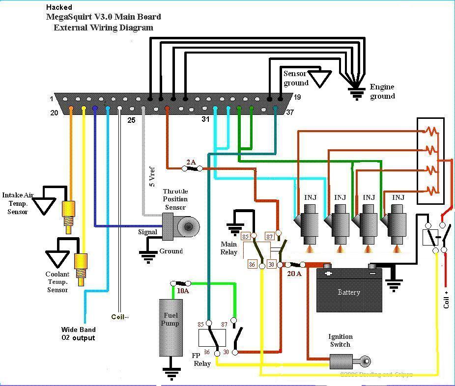

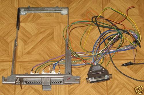

I going to wire megasquirt through the original mr30 wiring, and I need the connector of the old ecu to connect through,
also since this is my daily drive, I need to be able to plug the original ecu back in if I can't get megasquirt to run properly over a weekend.
here's a picture a what I want to do
