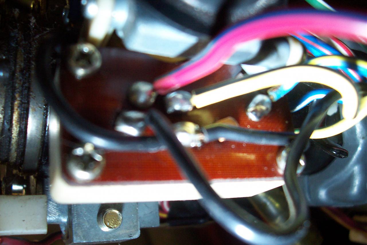

So I took a look at the wiper switch solder, everything looks good. All the solder is clean, all of the connections are tight and nothing has run. No exposed wires, none of them are broken.

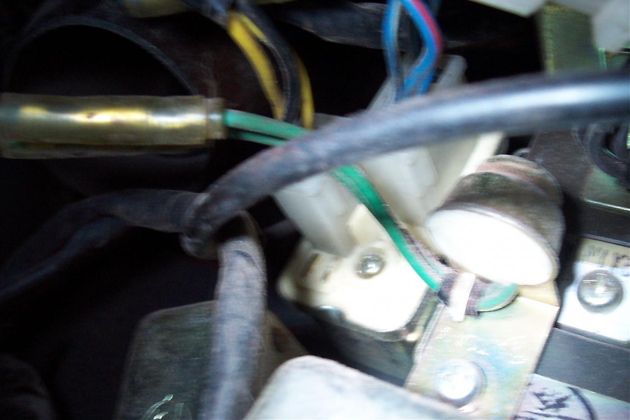

The 2nd pic is the relay on the passenger side thats clicking when the wipers run. I assume thats some relay, but couldn't find it in the BD catalog or at Courtesy. Is that a wiper relay, and could it be the problem? And if so, where can I get one?
