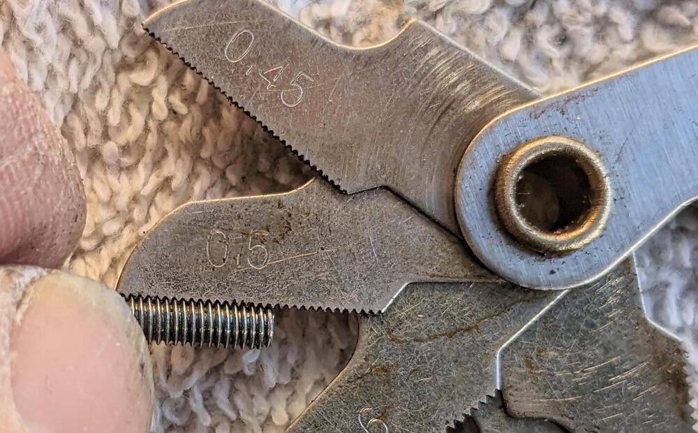

On 4/17/2019 at 11:07 PM, jalexquijano said:
What about the size and type of screw that goes through the steering wheel shroud and into the turn signal switch
Probably no use to the OP - these are the 3 types I found on my 280Z.
4 shroud screws, approx 15mm L
1 M3 x.5 12mm L pan head machine screw into combi switch housing
1 M4 10mm L machine screw into ignition switch housing (didn't bother measuring pitch, it's the same as all the other M4 machine screws on the dash).
