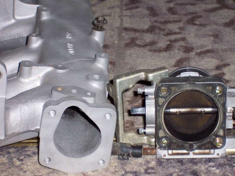

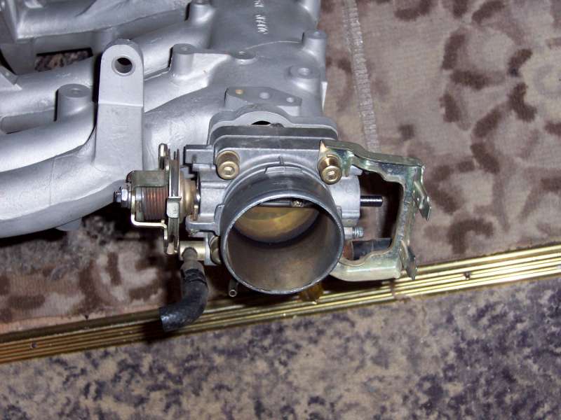

Hi,
I just brought a 60mm throttle body of a KA24e,
these can be found on 2.4 liter Pintara T and Ti models,
or in my case a Ford Corsair 2.4 Ghia (89-92), they are re-badged Nissan Pintaras,
they have the same bolt pattern, but you would need something in between, to cover the bulge in the intake manifold.
see pictures
Nigel

You could fill that hole up with epoxy steel (jb weld etc) I used it on a hole in my manifold on the K and it lasted a year getting hot and cold with no problems, mine was used as a daily driver as well.
After doing some research on http://forums.hybridz.org/ it appears that a 1 inch spacer is used with this mod, to allow the use of the original linkages, and the spacer also covers the "egg" shape hole in the intake manifold.
After I get my Megasquirt running, I'll look at fitting my 60mm KA24e throttle body.
