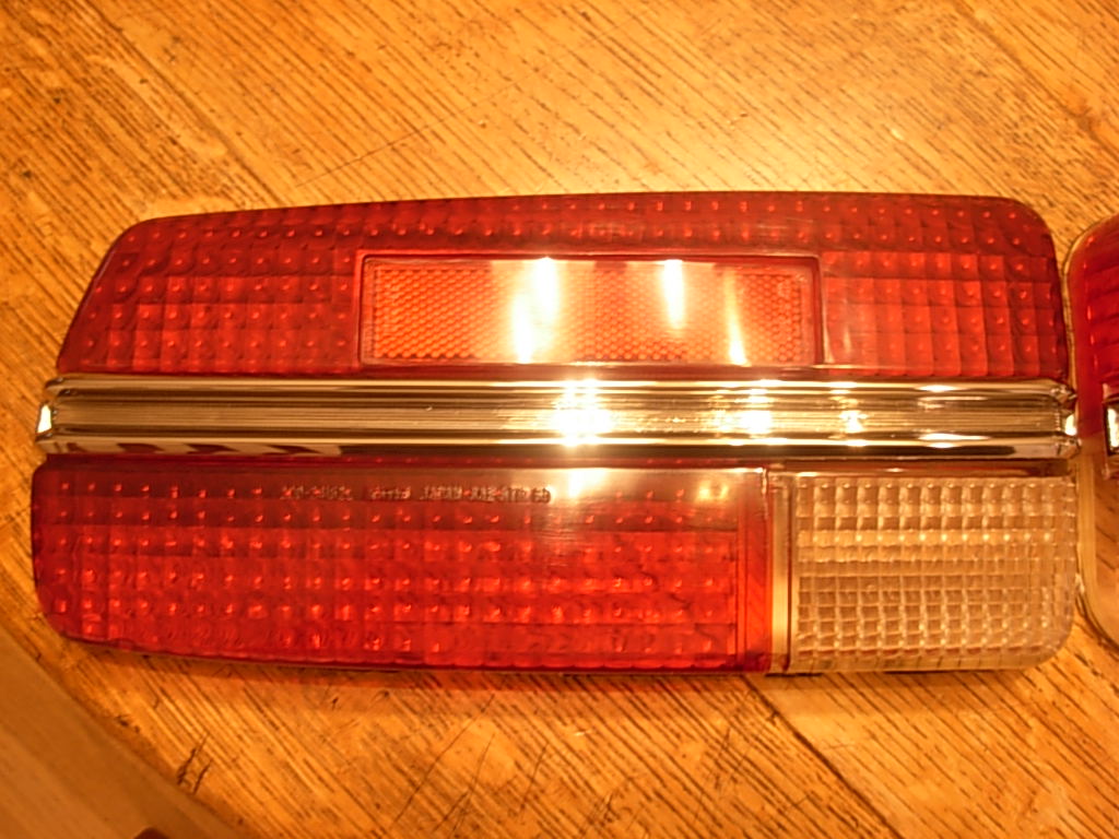

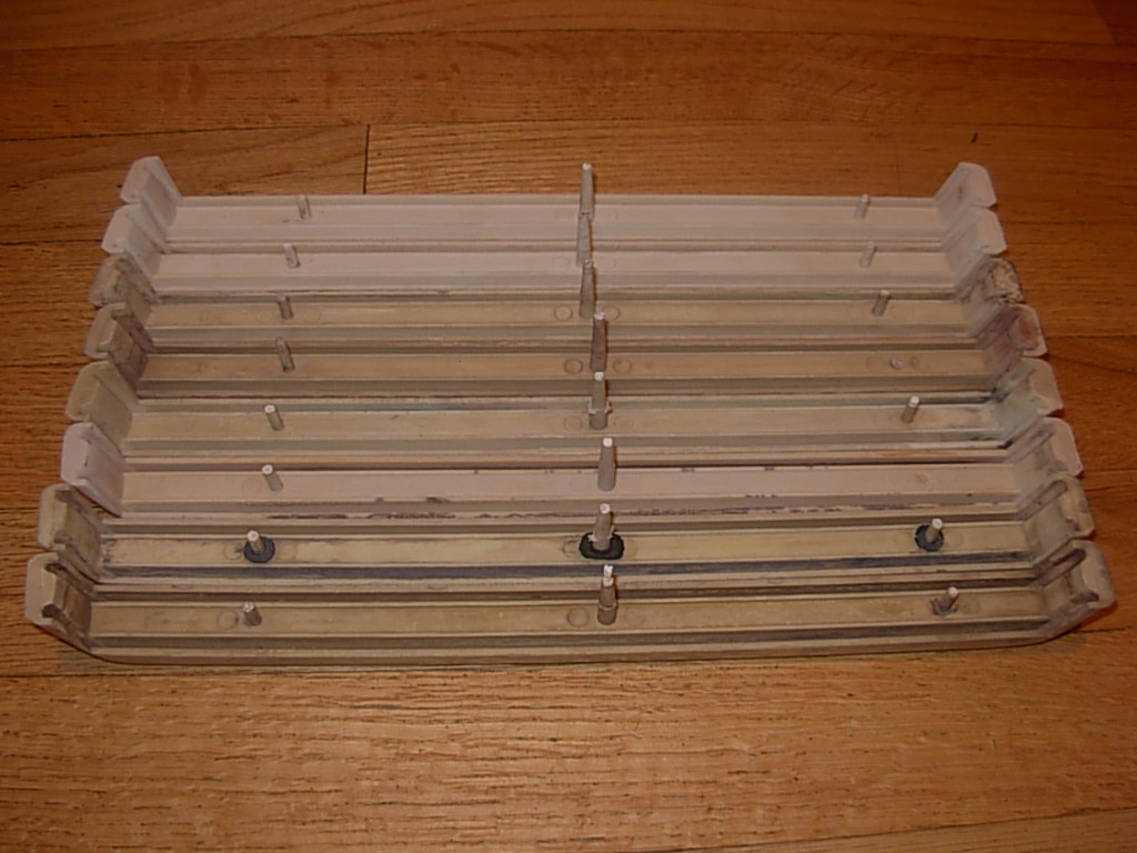

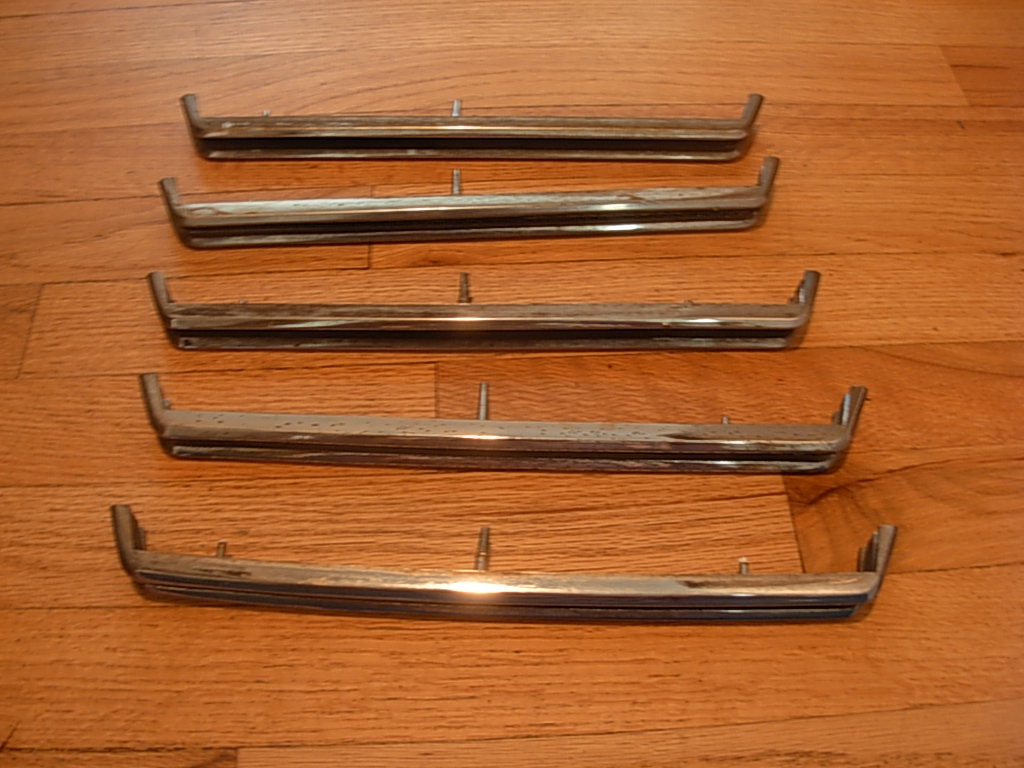

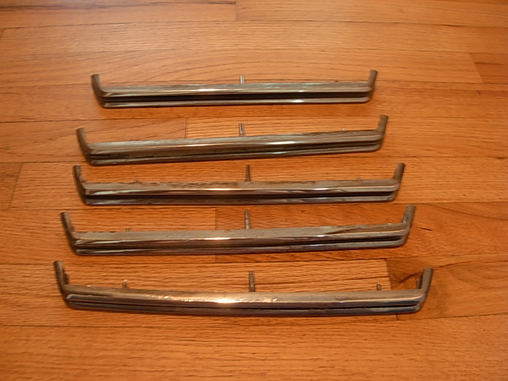

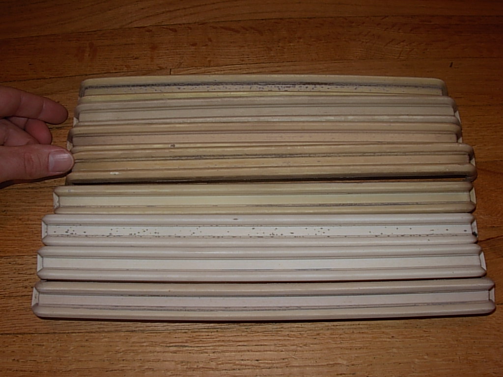

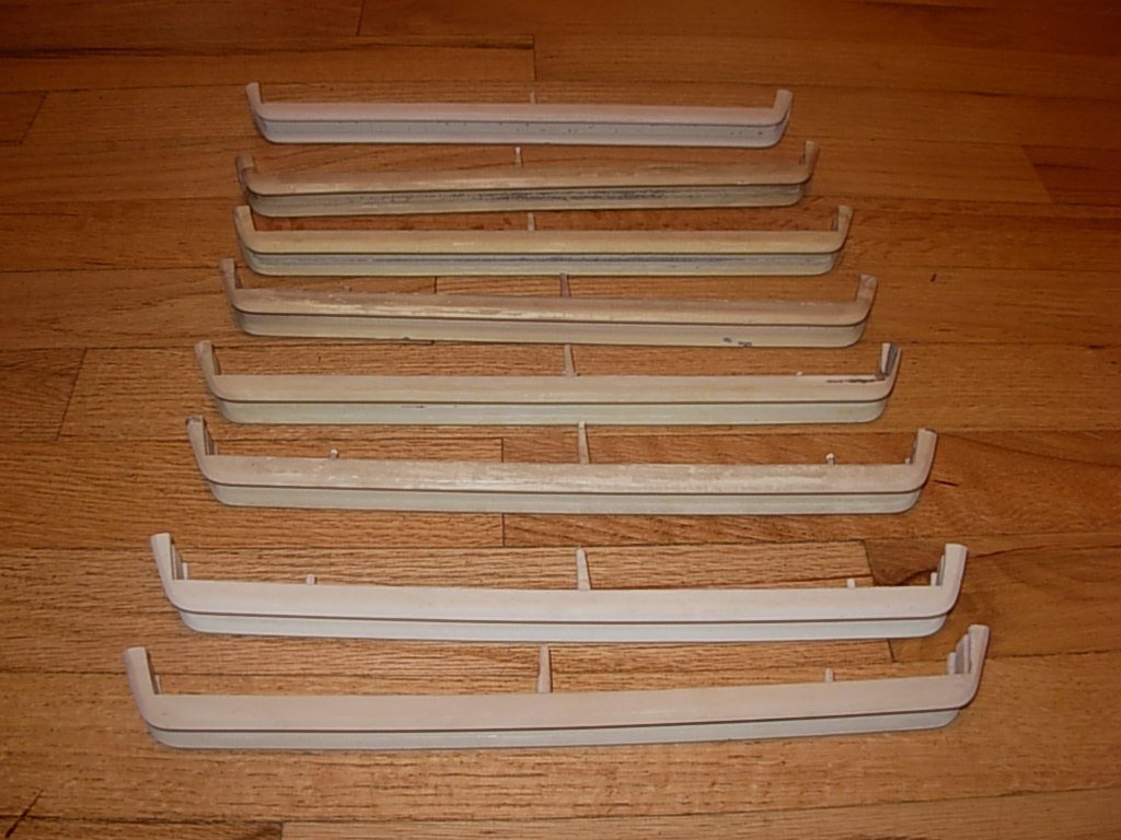

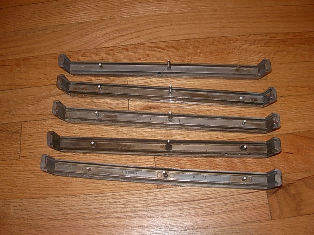

Mike B Posted November 22, 2008 Share #30 Posted November 22, 2008 Several months ago I decided to try to get the taillight trim for my 240Z replated. I broke apart all of the sets I have with bad chrome (most all of them). I stripped the chrome off with Muratic acid, as I mentioned earlier in this thread. Here are some pictures of what I started with and what they look like after I removed the chrome. I bought some POR-15 expoxy putty and filled and sanded any damaged areas. Unfortunately, I can't find the pictures I took after I completed that step. -Mike Link to comment https://www.classiczcars.com/topic/28354-electro-plating-tailight-trim/?page=3#findComment-267071 Share on other sites More sharing options...

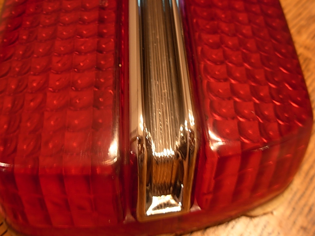

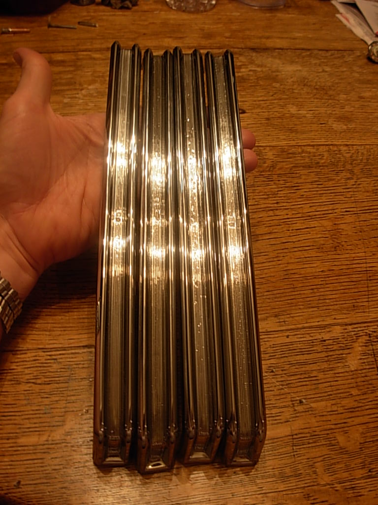

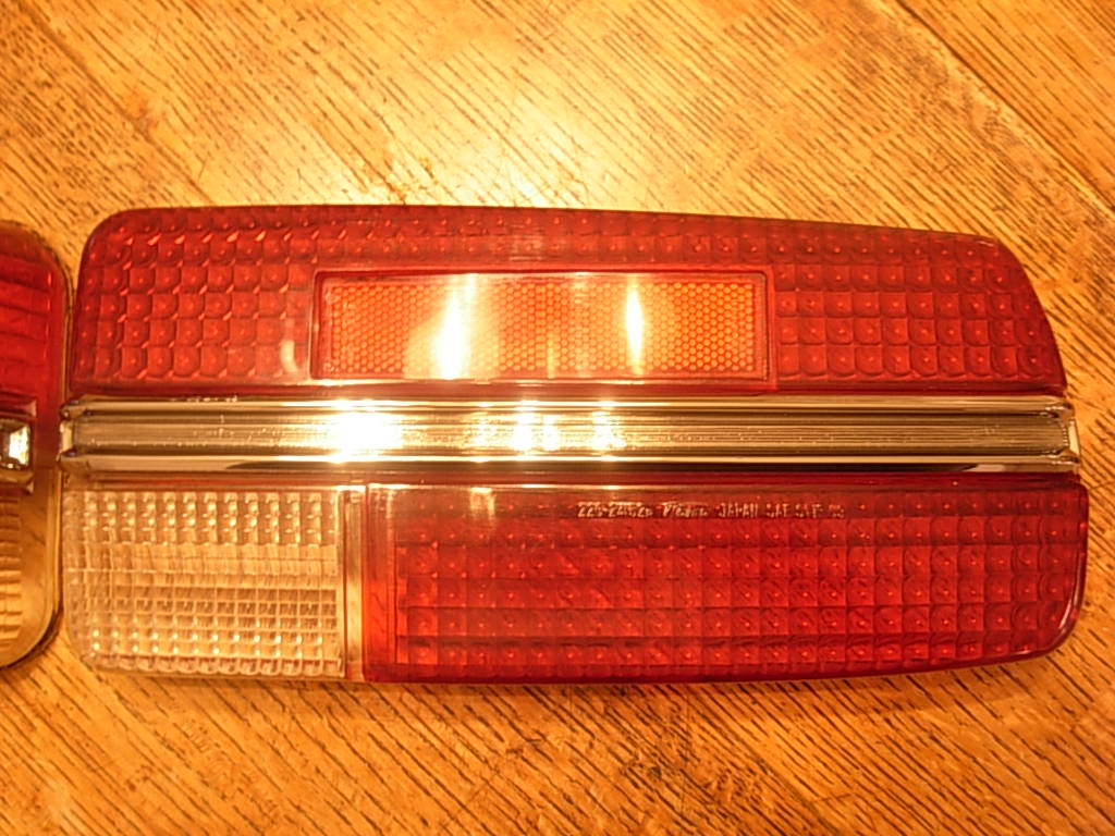

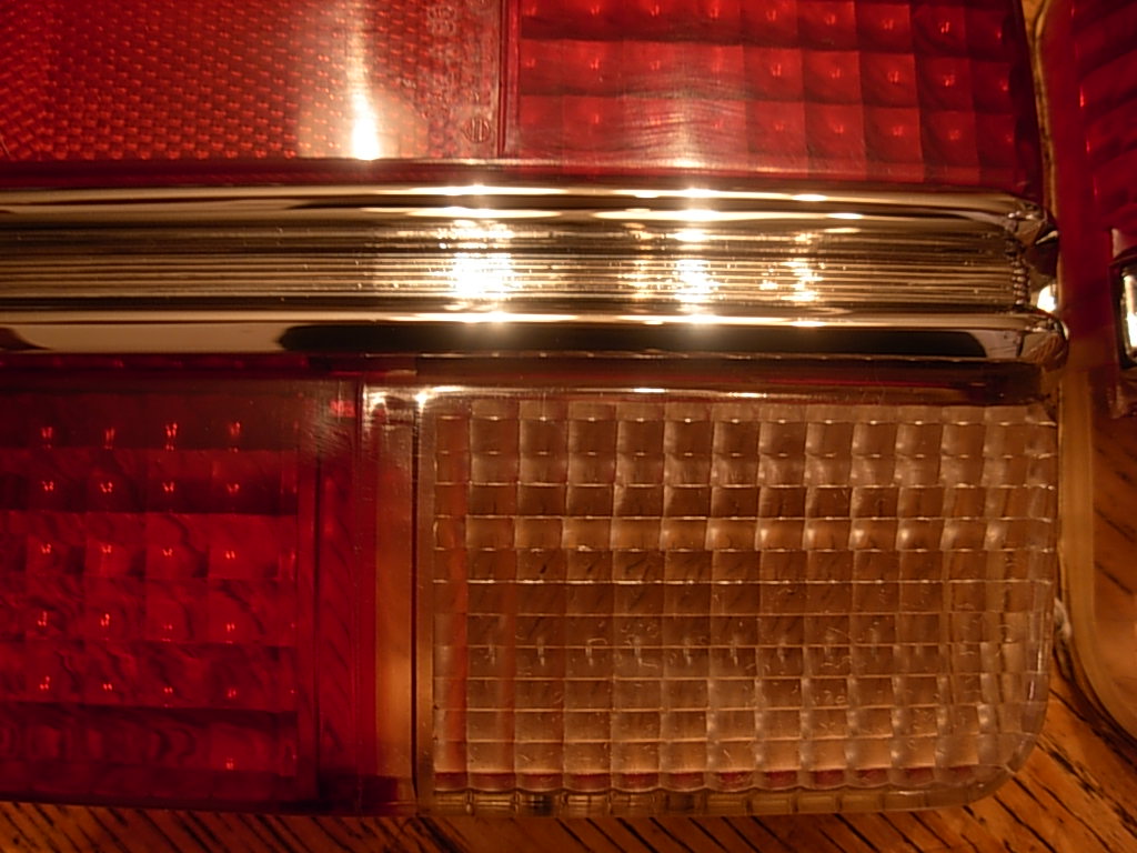

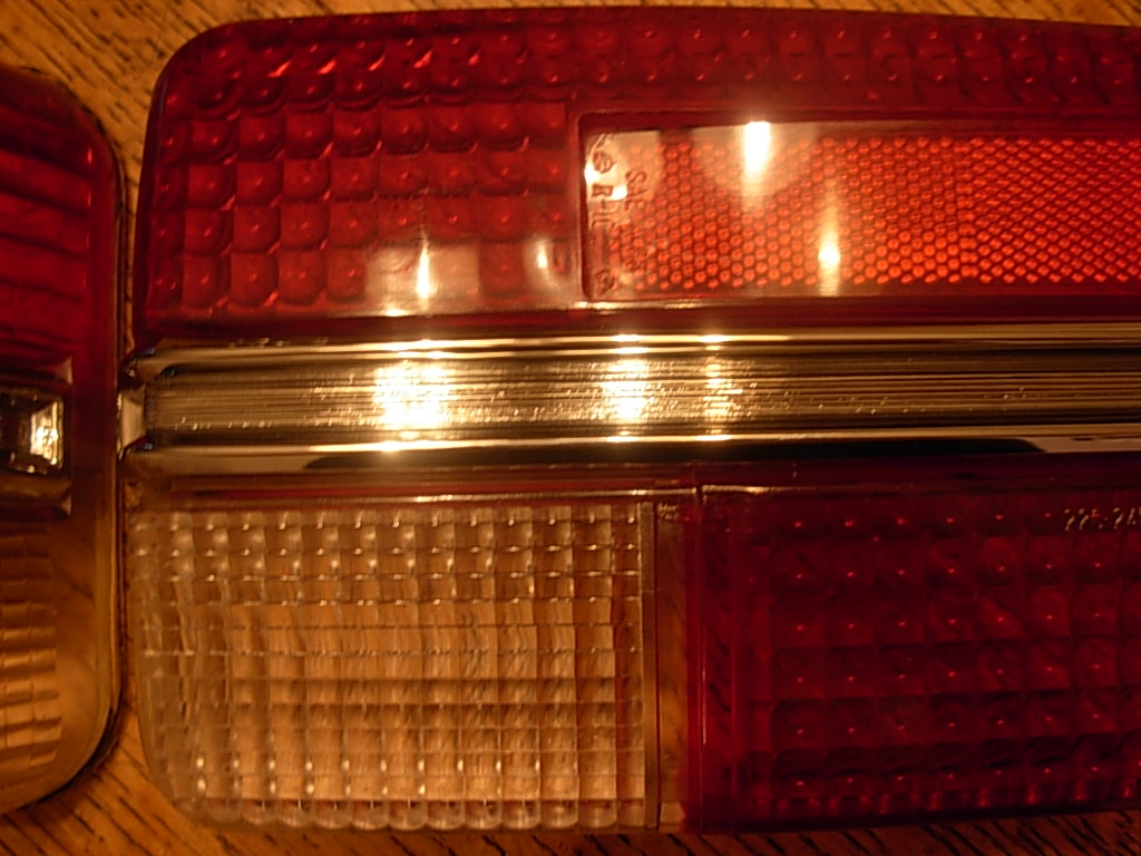

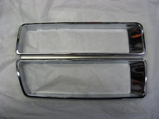

Mike B Posted November 22, 2008 Share #31 Posted November 22, 2008 I searched around and found someone that could electroplate plastic, so I made a deal to have him plate 2 sets of taillight trim and several other things for me. It was a package deal, so I can't really give an exact price for just the trim, but it was a little less than Zeddsavers price of $150 per set. After a lot of drama and months of wondering if I was ever going to get my stuff or my money back I finally received the replated trims and some of my other plastic items a couple of days ago. In my opinion they look great. I was very pleased that the middle detail still looks really good. I was surprised at how heavy the trims are after plating. It looks like a real quality job. I think they will hold up much better than the factory plating. I did some initial polishing of the plastic cases tonight and put the chrome trim back on one set. I still need to paint the middle sections black and put the backs on. Unfortunately, I'm still working on getting the rest of my stuff back, so I can't really recommend this guy yet, but I am hoping he gets his situation back under control and doesn't go under with this down turn in the economy. I'll let you know how it goes. -Mike Link to comment https://www.classiczcars.com/topic/28354-electro-plating-tailight-trim/?page=3#findComment-267072 Share on other sites More sharing options...
