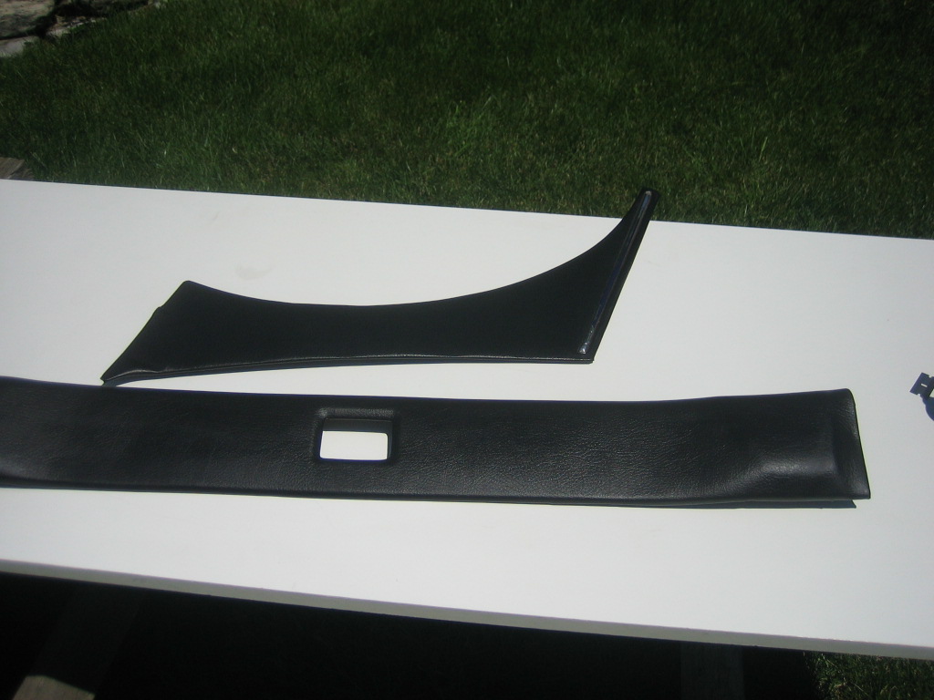

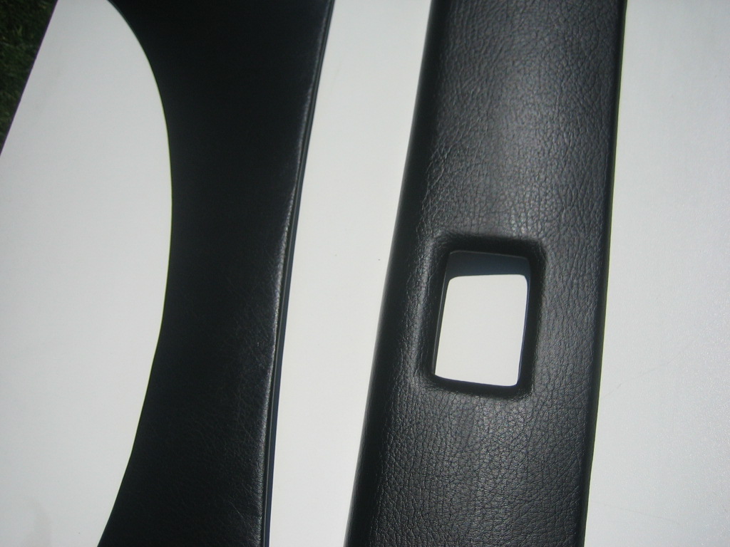

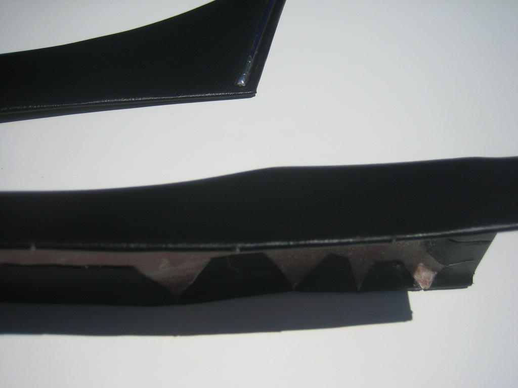

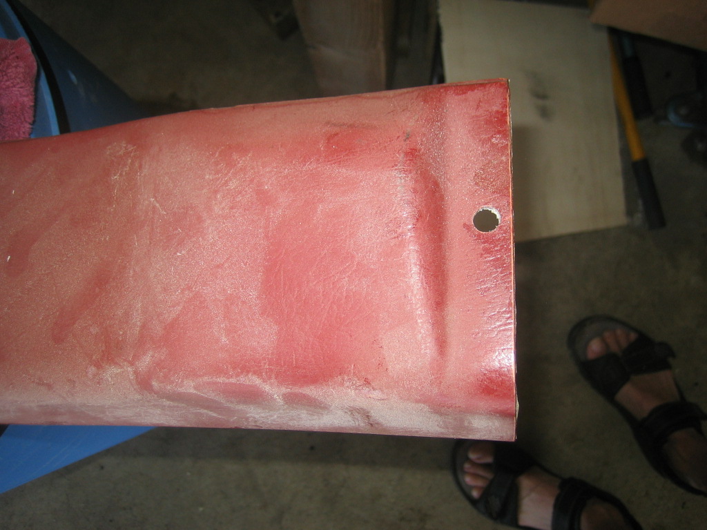

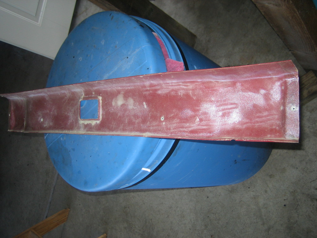

I've been wanting to do something different as far as attacking the flimsy interior plastic in the early Z. I could buy some new and spend 500$ for a complete new plastic interior or try something different and maybe better to some. I finally finished off one panel today. Basically I just fiberglassed the back side of all my panels to strenghthen them plus repair any cracks or broken pieces. Then I plan to vinyl cover the panels. I thought the vinyl would match the rest of the interior plus provide some noise suppression and the panels would be much stronger and last my life time. I picked out the easiest panel today to cover with the vinyl(which i found a perfect match at Joanne fabrics). I learned today that i will have to getter better tools for the job. 3m is great stuff but i need a better way to spray the panel. The aresol can sprays to wide which makes for sloppy work.I also cut the material too close to the panel in several spots which i tried to show in the pic, but I think I know how to remedy that. I also odered the specific glue to spray with my gun. So far i have $ invested:
30$ vinyl
60$ glue and spray gun( that's a gallon of glue)
40$ fiberglass resin and hardener
20$ fiberglass cloth
As you can see i don't have a lot of money in it, but I didn't do this just to save money, I did this for the look also. I am not using the original vinyl, i will be carpeting everything else in the car. So there shouldn't be vinyl overload.I actually enjoy this kind of work too. Of course, once i get to doing the more complicated panels i might not like it as much
