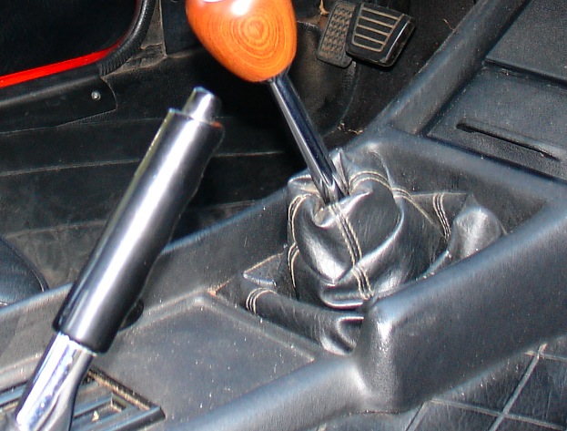

Turns out we're both right, E. The automatic console for '71s had material removed from both the front and the rear of the shifter opening to accommodate the auto shift selector.

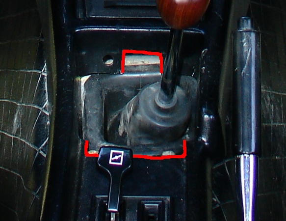

The first picture I attached is a normal manual transmission console in place, with it's boot. The second picture is a manual transmission console in place, w/o boot. (The fact that the car pictured was converted from auto to manual is immaterial. The console and boot and such all attach the same.)

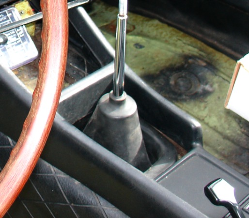

The third picture shows an auto console w/o the shift selector or a boot. I marked the places where material is missing (when compared to a manual console) in red.
The key to this original question is this - a manual transmission console will attach to an automatic transmission tunnel exactly the same as the original auto console did, as long as you have the proper one. If the automatic car is a '71 (through 8/71 or so), you need a manual console from a '70 or '71 car.
