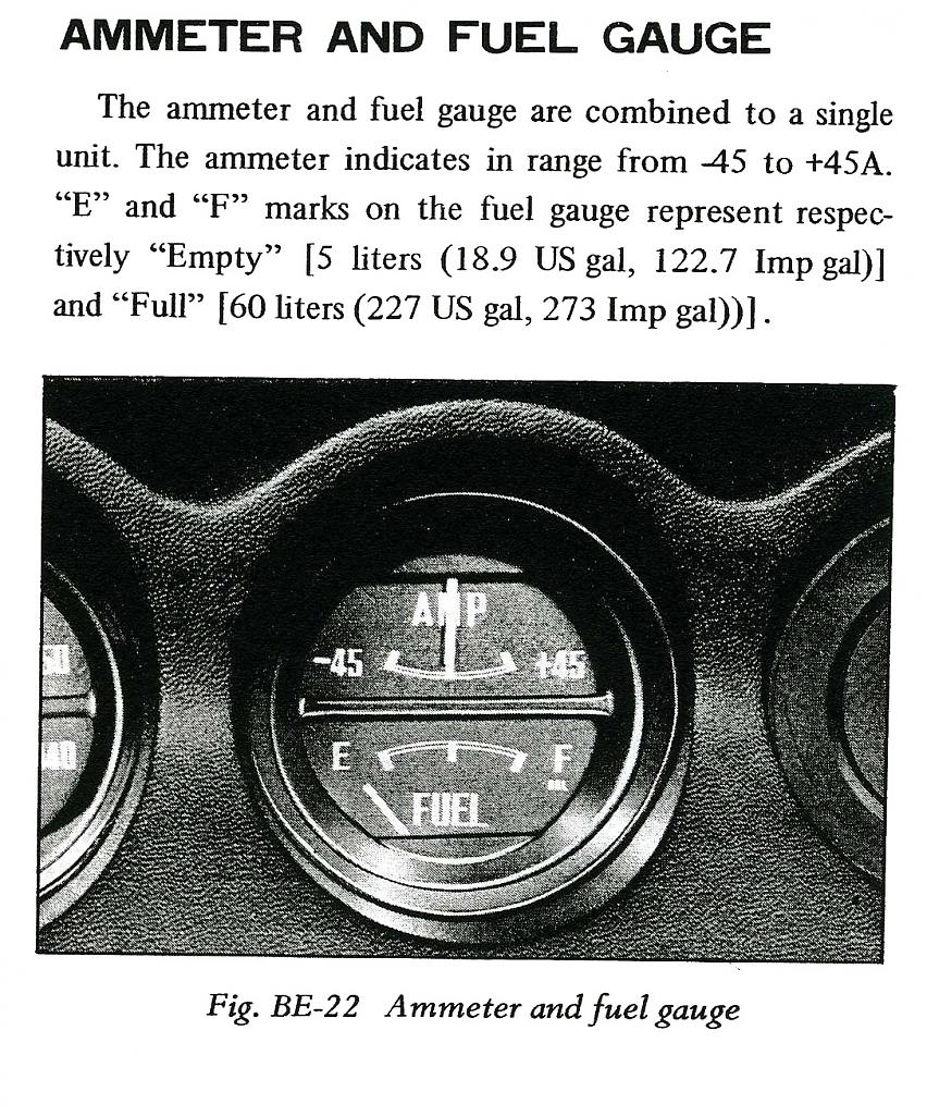

Do you mean VOLTMETER or AMMETER?
I really need to know which it is, VOLTS or AMPS.
A Voltmeter is usually marked from say 9V to 15V no polarity indication whereas an Ammeter is centre zero with markings of
-45, 0 and +45 for example.

Thanks for your reply Nissanman.......It is the ampmeter on the dash....It's reading all the way to the right at higher RPM and stays there till I go to idle. I installed a new alternator and then went back to the old alternator with the same result. I have a new voltage regulator here I could try........could that be the problem? All connections are as were before the rebuild.

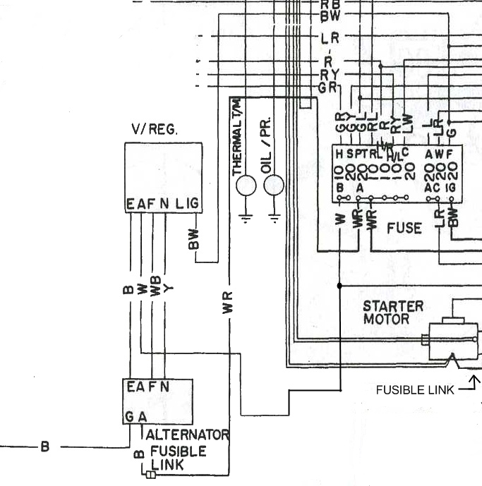

The fact that the alternator charge current climbs with engine RPM indicates that it is more likely a Regulator issue, or, a wiring problem between the Alt. and Reg.
Here is a diagram of the typical Alternator and Regulator wiring connections,
The B wire at bottom left is a GROUND wire.
