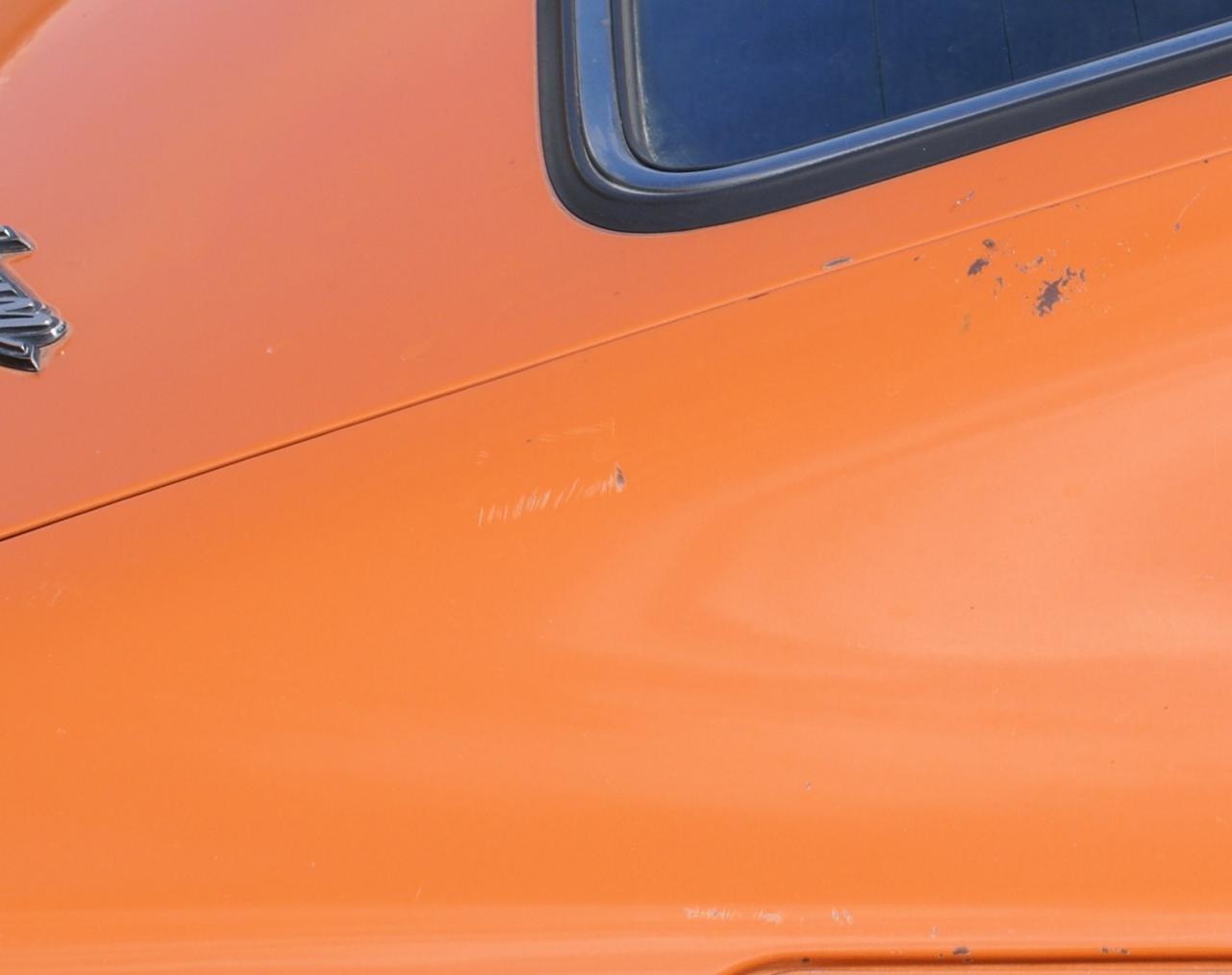

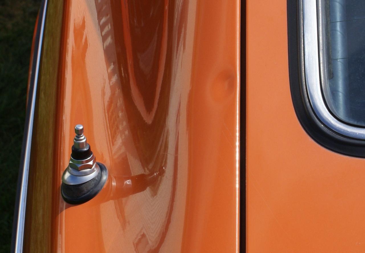

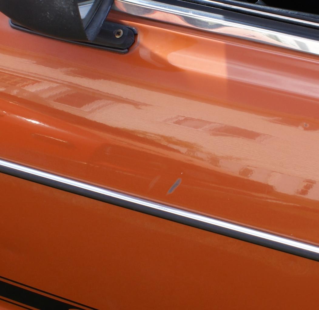

I may have been a little bit picky initially when I saw the car, when shipping long distances things happen - particullarly when the vehicle changes carriers several times en route. I got the low shipping rate (in relative terms), but paid the other way.
The vendor put a bra on the car prior to shipping (at my request) and one of the truckers tried to start the car to move it to another truck, (the ignition is tricky) when trying to start he thought the battery was dead and popped the hood to boost it and ripped two slits in the vinyl bra (now garbage).
I took some pictures of some of the body damage but they show very poorly in a photo. Minor dimples are almost impossible to see unless you are looking from the correct angle - the drivers door appears perfect in a photo but standing beside it it shows several dents. I wll get creative with lighting later to see what I can do to illuminate the issue (see what I did there :))

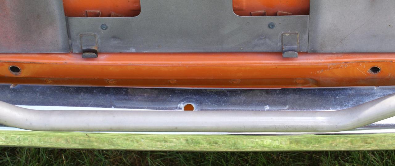

Here's some things that are obvious (now) - the bumper shot is the unmentioned trailer hitch.

Rick, I know you were a little disappointed in the bumps and scrapes that the car incurred during shipping, but I have to tell you that this looks like a very solid car to me. Shoot a coat of paint on her after you get the mechanicals done and you'll forget all about these little dings and scratches. Congratulations! This is a nice car.
