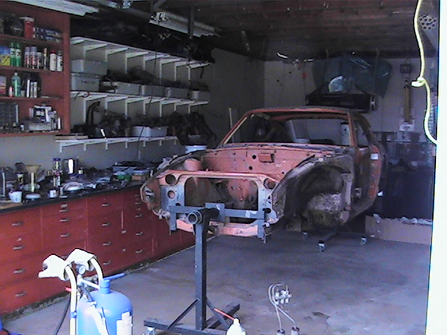

Seppi72 Posted August 3, 2008 Share #1 Posted August 3, 2008 Just got home from trailering my car to the sandblaster. It turned out to be fairly easy and straight-forward, even though we had prepared for something more elaborate. I've had the shell on a rotisserie (see attached photo) for about a month as I was finishing up the removal of the last bits of hydraulic lines and wiring harnesses as well as scraping off undercoating (oh, what a F-U-N job that is). We were expecting to have to use an engine hoist to place the shell on a body dolly to make the transfer, but my body guy thought that the rotisserie was strong enough to handle things for the 5 mile trip. We pushed the loaded rotisserie onto a flat-bed trailer (remarkably easy, I have to say - we didn't even need to use the winch) and used straps and "come alongs" to hold things down and in place. Then it was off down the roads (admittedly back country roads). No muss, no fuss, no bother. My baby's now at the sandblaster and we'll likely start on things tomorrow. Blast, inspect, treat if needed, and epoxy prime each day. With luck, we'll have this portion of the job done by next weekend and we can then take the whole thing down to the body shop for the real fun-and-games to begin. You know, after thinking and dreaming about this for the past 25+ years, now that it's well and truly underway, it just seems unreal. I can hardly wait to document the process. Any and all tips and tricks regarding the sandblasting of S30 models are welcomed. Link to comment https://www.classiczcars.com/topic/28896-my-babys-off-to-sandblast-land/ Share on other sites More sharing options...

Zedfoot Posted August 3, 2008 Share #6 Posted August 3, 2008 Be carefull moving that shell on a rotisserie. My shop, www.bodybybiggs.com refuses to use one as they have had cars (American, mind you) bent out of shape that way. Apparently you don't find out untill final asembly when doors and panels don't quite fit properly.Go to http://www.flickr.com/photos/janeeric/sets/72157606153458051/ for the whole story on media (broken glass in this case) blasting. No need to strip undercoating, the glass is sharp enough and with lots of air (80 HP compressor) the metal doesn't heat up. Link to comment https://www.classiczcars.com/topic/28896-my-babys-off-to-sandblast-land/#findComment-255229 Share on other sites More sharing options...

Seppi72 Posted August 12, 2008 Author Share #10 Posted August 12, 2008 The work happened over the course of about four days last week and we finished up yesterday afternoon with the final epoxy priming. Now we just have to wait for room to pen up in the body shop and we'll transport the shell there for rust repair.In truth, as JimmyZ and AggieZ said, getting all the sand out was a major task and took well over eight hours of my time alternating between the air hose and a shop vac. I also found that "spinning" the shell on the rotisserie really helped to get the sand moving so it could be removed. Even so, every time we rotated the shell to prime, there was more sand showing up. Fortunately, none of it got caught up in any fresh epoxy.As for treating residual rust, I ended up using Ospho. I used an artist's brush to apply it along every spot welded seam since there undoubtedly has to be rust in those locations. I used a 1" bristle brush to get up into the shock towers where the sand couldn't be directed. Again, having the shell on a rotisserie made this task quite easy (and no phosphoric acid dripping onto my face). I used a 1" foam brush to apply epoxy to these same hard-to-access areas.The other regions of concern were the frame rail tubes underneath the rear deck. There is no way to get sandblasting in there, so I resolved to treat the interior portions with Ospho. The sandblast guy had an old siphon gun originally designed to apply undercoating. This had a 3/8" diameter, 1. 25" long cylindrical aluminum tip with two slots cut about halfway through into the end so that the discharge would be a fan spray coming out at a right angle to the cylinder axis. I used threaded hose barb fittings to secure the spray tip to a 3-foot length of reinforced 1/8" ID vinyl tubing. A similar fitting at the other end attached the tubng to the siphon gun outlet. I attached the tip so the the discharge slots were aligned with the identification info printed along the hose. This way, I could tell which way the slots were facing. A little experimenting with water showed that a nice mist was created at the tip with about 70 psig air.For the frame rails running parallel to the axis of the car, with the shell in the "normal" attitude, I inserted the tip and tubing through the holes underneath the shock tower braces from inside the car; either running forward or backward as needed. I fed the tubing to the end of the run and gradually withdrew the tubing while the spray was discharging. Knowing that the tip was facing upwards, I anticipate that it hit the "roof" and sidewalls and ran down to coat the "bottom" of each rail interior. Any excess Ospho ran out of the water drain hole at the end of each run and was caught in plastic pails.On the passenger side, there's a cross tube in the aft leg that allows a fuel line to pass through. For that leg, I also had to insert the tip from the end drain hole. Fortunately, there's a corresponding hole in the rear deck that gives access. This had to be slightly elongated so I could insert the tip.For the cross member frame rail, we turned the shell 90 degrees, inserted the spray tip towards the "up" end of the rail and sprayed while I slowly rotated the tubing and tip inside the rail. We kept this up until we saw a goodly amount of Ospho run out of the lower end. We then rotated the car so the other end was "up" and repeated the process. This method, I believe, is the best way to treat any interior rust short of dipping the entire car.There's some rust through to repair on the aft crossmember (the one that runs parallel to the rear bumper just inside the sheet metal) so I'll Ospho that when the bad section is cut out. Link to comment https://www.classiczcars.com/topic/28896-my-babys-off-to-sandblast-land/#findComment-256270 Share on other sites More sharing options...
