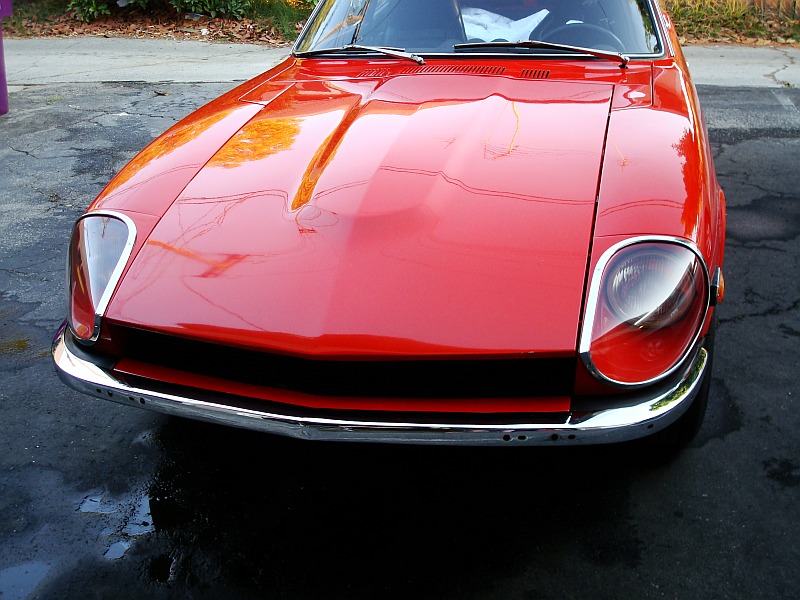

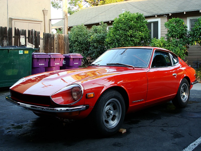

Anyone else out there bought a set of these reproduction headlight cover sets only to find they don't quite fit. There close but it's a no-go on the bottom hole. You really can't flatten them to make it fit because you loose the outside curve. I got lucky because I bought a set of rings ( that we talked about here on the board) about a year ago. There not new but they are original. Anyway I popped out the lenses dropped them in the other rings and damm they fit perfect. I used aluminum nut-serts for the install. works great. Anyway here's a pic. Oh, I did a spring and strut install this week too. Got it down 1.5" sits real nice now.

Well that's just it, I have a set of the reproduction rings and they don't fit. There too short at the bottom. The ones I have on the car are a set of originals I bought without lenses. I got lucky that I had them. The repros are going on the shelf.
Ok, so the style of repro ring you had wouldn't fit the car, but the lens would, eh... In any case, they look great, and my feelings are usually divided on whether I like headlight covers or not.

Which typically come with no mounting rings, but a rubber seal allegedly to be affixed with 3m tape. Which would be the route I would take, as there's no way I'm drilling into my car. :finger: Though admittedly, the chrome rings on yours do sorta make the car... (I'm assuming those are the original, optional style... am I right?)

My chrome rings fit reasonably well (bought them back in 2005-6), but had to be flexed slightly to mount up properly. Small 1-2mm gap along the underside, but it allows moisture to evaporate without condensing on the inside of the lens. My seller was US-based, but had Japan contacts. They weren't OEM, but were JDM repros.
