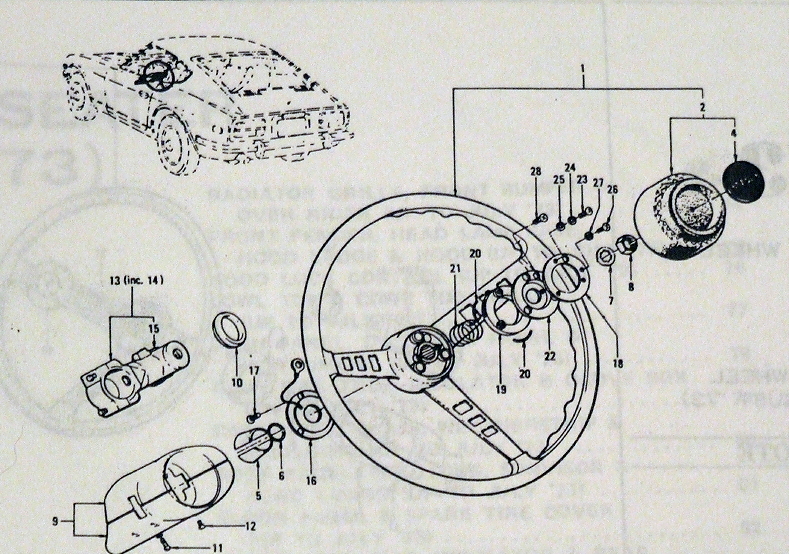

Now I have an even "dumber-er" question - I can't find the mounting kit / parts...at least not online. Arne once pointed out that you can get parts via a Nissan dealer, but I am not confident in my local dealer.
I did see a Grant steering wheel mounting kit at JC Whitney. Obviously, it's intended to mount a Grant steering wheel - wondering if some of the parts could be sourced to mount the horn pad on an OEM wheel...anyone know?
Am I making a bigger deal out of this than it needs to be?

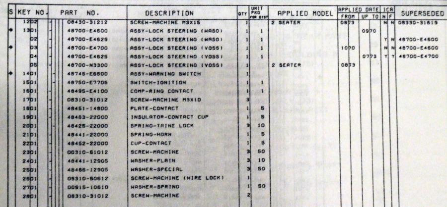

Maybe this will help....
I was looking for some of these parts as well - found them on ebay rather inexpensively.... I needed replacement for #19 because it cracked and one of the #20 pieces that grips the pad/button had broken away leaving the pad to rest in your lap after each good bump.
