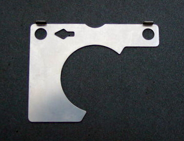

The shims are a backplate to the pads right? The only thing I really did was take the pads from the old caliper, pop them into the new one; and secure them with the clips. I'll have to double check if there are any shims.
Yes. See part #2 in the photo below from the Black Dragon catalog.
If they're not in, it would cause your problem.
The brake shims from Nissan look like the attached picture. Some people swear that this is the best to use. There is a left and right for each caliper; four used for a complete job. Nissan dealer can provide them for a bit over $2.00 each IIRC.
Attached photo is of a right shim.
