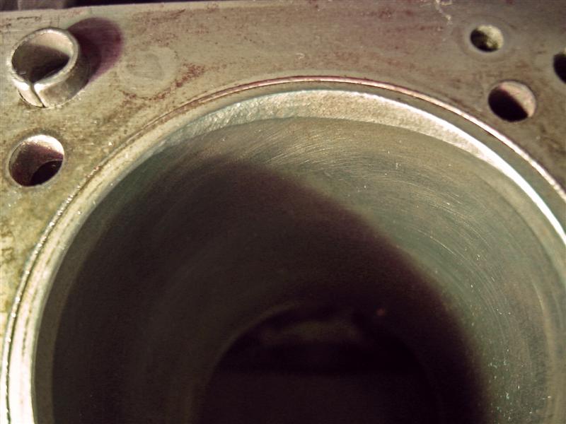

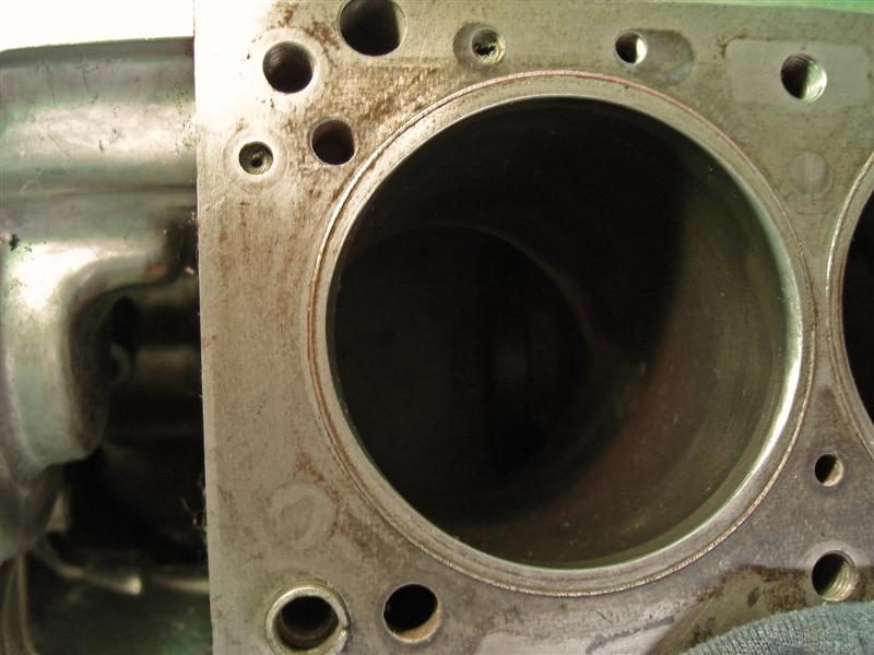

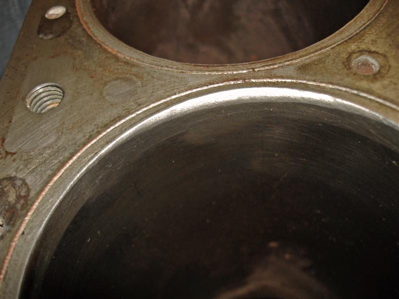

It all depends on the bore size, valve lift, and valve size. It should be checked to give you peace of mind, and to possibly save some damage. If you feel good about your die grinder skills, you can do it yourself. It also has a side benifit of smoothing the flow within the cly./chamber. Two important notes: DO NOT grind down below the top ring! Stay above by about 1mm or so. Place a used head gasket on the block, and scribe the block, around the inside of the gasket. Then very carefully grind the block as in the pics below. The pics are of an "O" ringed L24 block.

All the heads/blocks I've done were full race engines, so I don't have any particular info on your setup. My guess is you won't have to do anything. If you choose not to check it, to verify it's not hitting, Just leave the spark plugs out, and turn it over by hand. But you need a small amount of clearance, and just turning it over won't tell you that. To verify, do a pre-assembly with one int. and one ex. rocker installed with only the inner valve spring installed. Set cam timing, run the valves to max lift, and push to open the valve further. The valve will open a little further before it crashes into the block. How much more it opens will tell you the clearance. Safe minimum distance is .060 Int., and .090 Ex.

Phred......That makes sense.....The block was bored out .040 and the intake valves are 1mm (.040 in. ) oversize so it would seem that the extra overhang of the valve would be offset by the overbore from stock....but the valve is coming down at an angle and that probably makes a difference. I think I'll go ahead and eyebrow just for breathing if nothing else.I always turn my engines over by hand also ( experience is a good teacher). Guy
