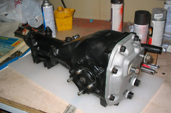

I agree with xray, I just finished doing mine the same way, as well I glass beaded the cover and finished it with a high temp clearcoat. Here is a photo
