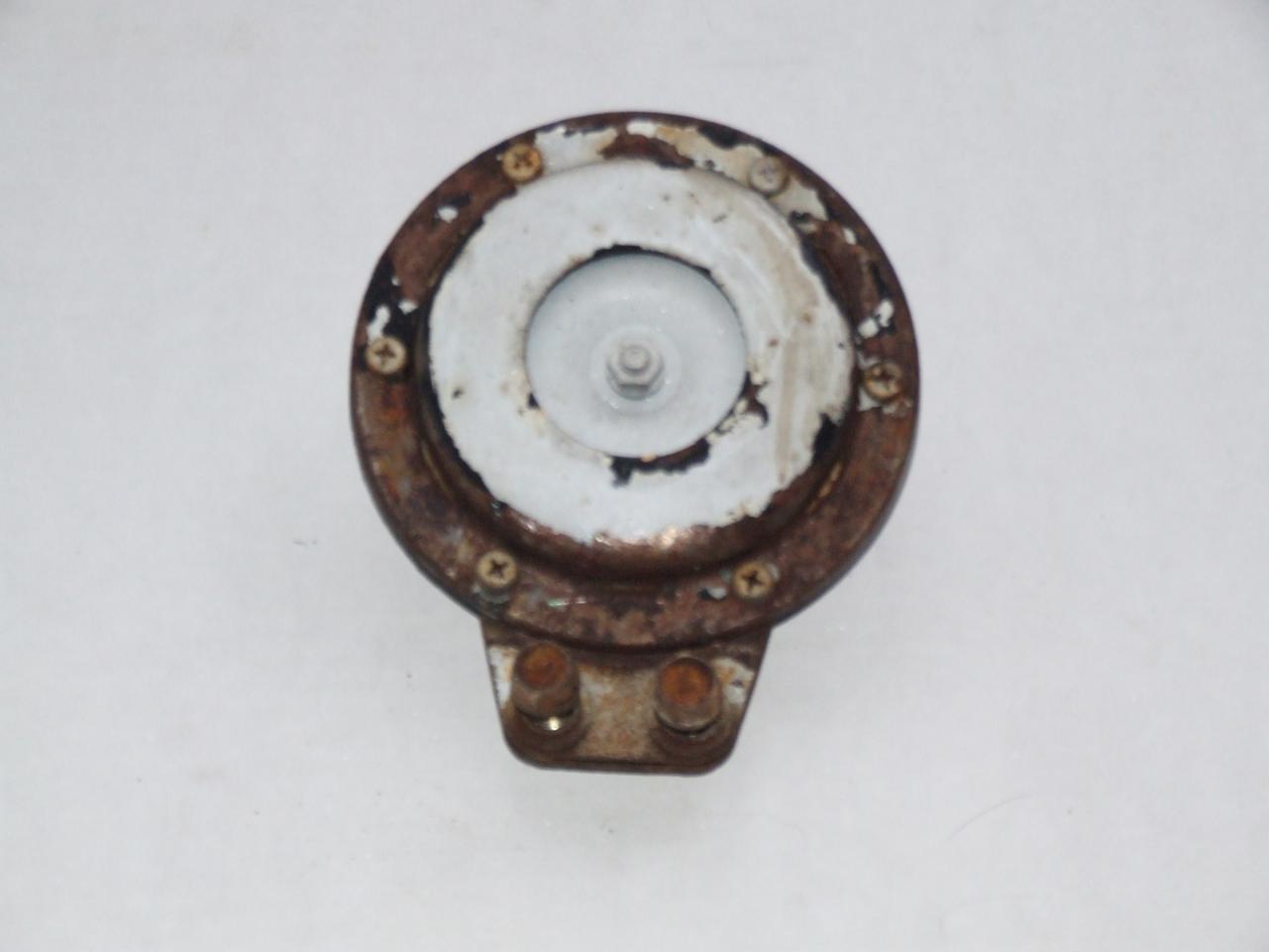

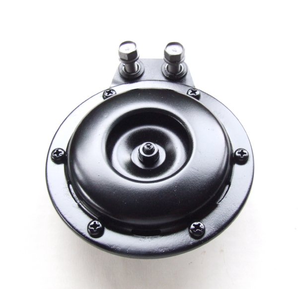

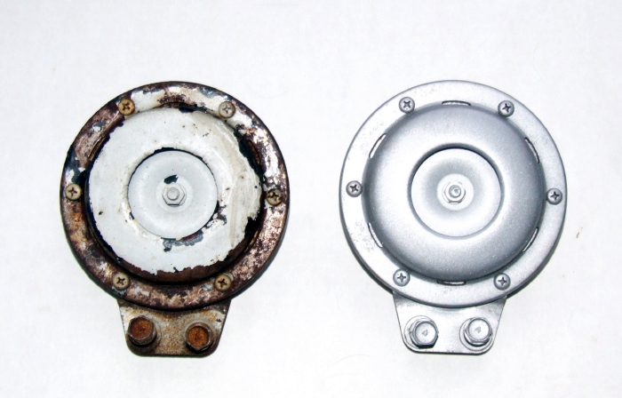

I've been having a lot of fun lately cleaning up piles of parts with my media blaster. My focus has been on mostly doing cast aluminum parts and nuts & bolts, and experimenting with different media. Today I looked at my horns and they were horrible, so I took them off, gave them a cleaning, and reinstalled them. If anyone is interested, I've attached a few pictures of 'before' & 'after'.
nasty, nasty....
but they cleaned up real well....

Drop yours in Parcel Post tomorrow and I'll have them done for you next weekend! (Not kidding..... ) Does the semi-gloss black work for you? I am guessing that is how they came new. Can anyone verify that or tell me otherwise?

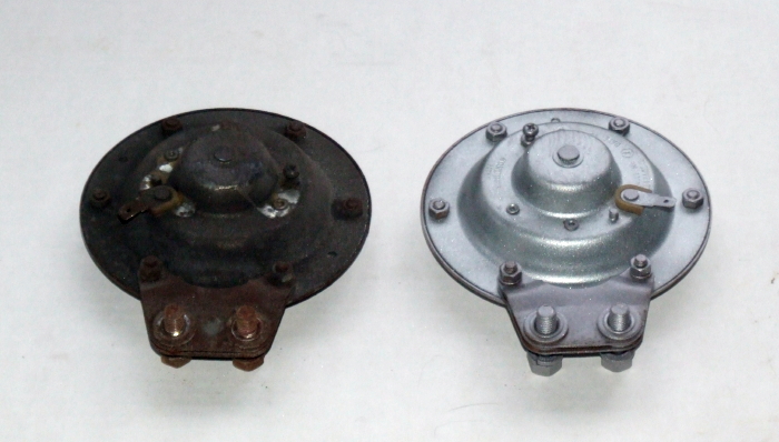

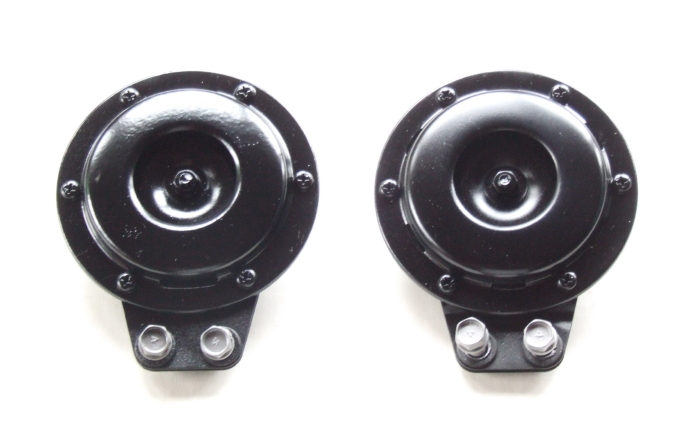

As for media on cast aluminum, it depends what you are starting with and looking for as an end result. For really dirty, stained parts, I use a medium or fine grit coal slag. It cuts nicely just about anything (also etches glass nicely!) This stuff is great for removing scratches, file marks (like those that remain after filing off some casting marks), etc. You'll find it marketed under various names, usually with the word "black" incorporated (e.g. Black Magic, Black Beauty, Black Diamond, etc.). Also, it's dirt cheap if you can find it locally and avoid shipping costs. A smoother finish can be had with fine glass beads. Often I will do two passes; first with coal slag, second with glass beads. In the blaster right now I am using a mixture of about 50~50% coal slag and glass beads. This gives me the convenience of being able to deep clean quickly and have a reasonably smooth finish (but not as smooth as glass beads alone). The picture of the blasted horn is an example what this media mixture does. I've found beads great for finishing, but not very good at removing (quickly) heavier rust, paint, etc. Coal slag is quick at that. Aluminum oxide and garnet are also great, but my sources make those prohibitively expensive. (If anyone knows a cheap source, please let me know!)
There is also room to get creative if you have different media at your disposal. Here's a picture of a cam cover that was finished overall with fine glass bead media, then I hand cut a resist of a "Z" and hit it with coal slag for about three seconds.... I call it the 'ghost Z'. I am looking for a good source of graphics for additional potential etchings, as a friend of mine has a plotter set up to cut resist material from good digital images (this will save me a ton of time with the X-acto knives!). This one was done by transferring the image (pencil etching) from the "Z" on the hatch of my '72, so it's an 'authentic' shape/font.
Generally I finalize everything with a coat of hi-temp clear coat. This mutes the 'sparkle' that you'll have after blasting and darkens thing up a bit, but the surface won't pick up stains and dirt nearly as quickly. There are other pictures of my tinkering in my gallery.
Thanks for your interest. I guess you can tell I enjoy the time that I spend at the media cabinet. I'm glad I got a big one, or I'd be out there looking to upgrade.
Attached: several shots of the cam cover with the two types of media used. I think that this is a good way to show the difference between glass beads and coal slag media as well.... Note that the lettering and lands on the top of the cover were mildly polished with a very fine grit wet paper, and also clear coated.
