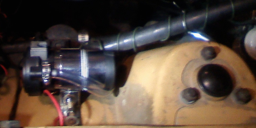

1) compressor mounted- I used a spare chrome ignition coil mounting.

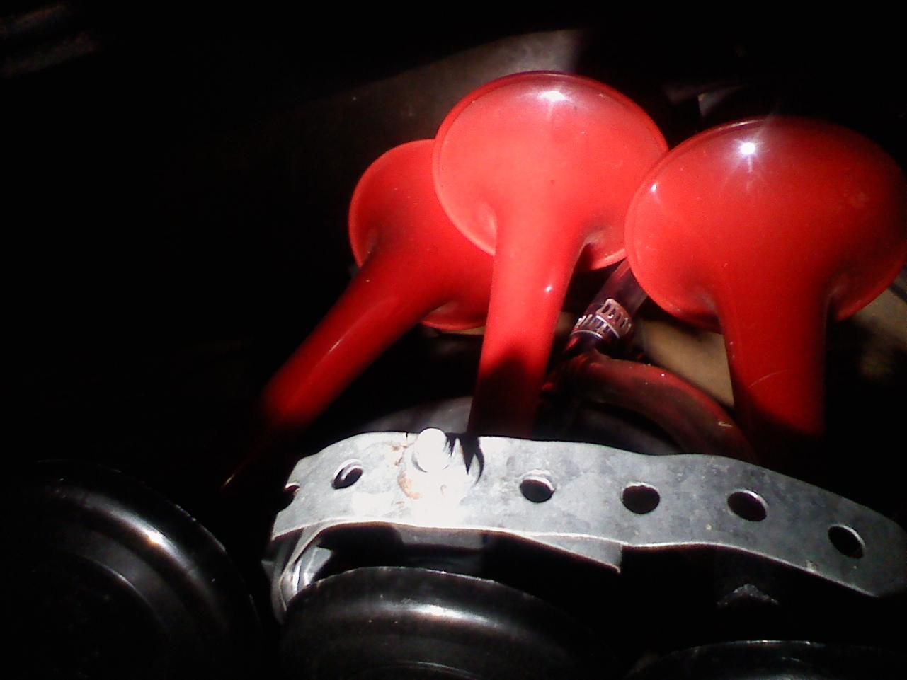

2) horns- direct view

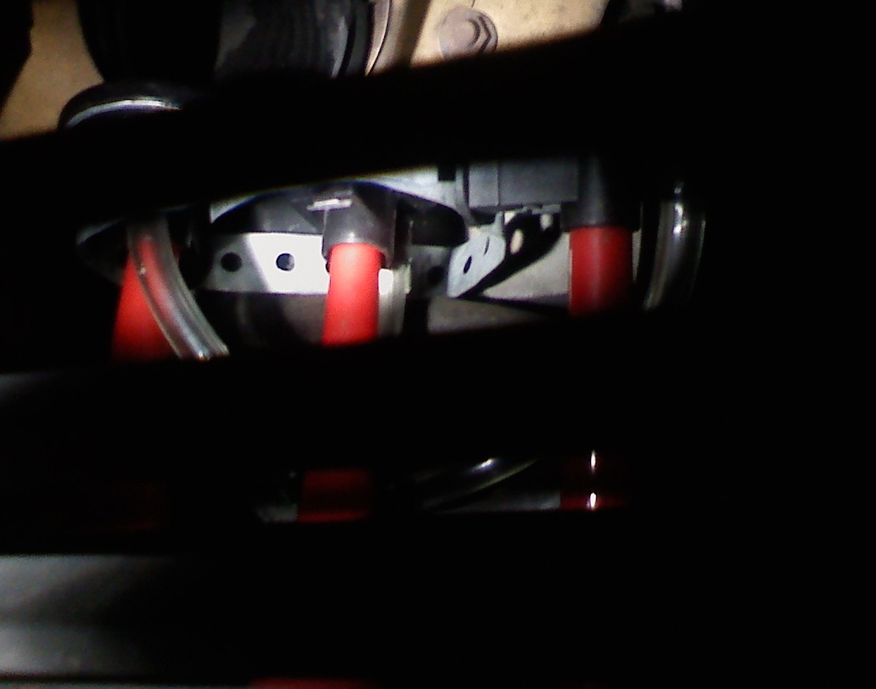

3) horns as seen thru grille

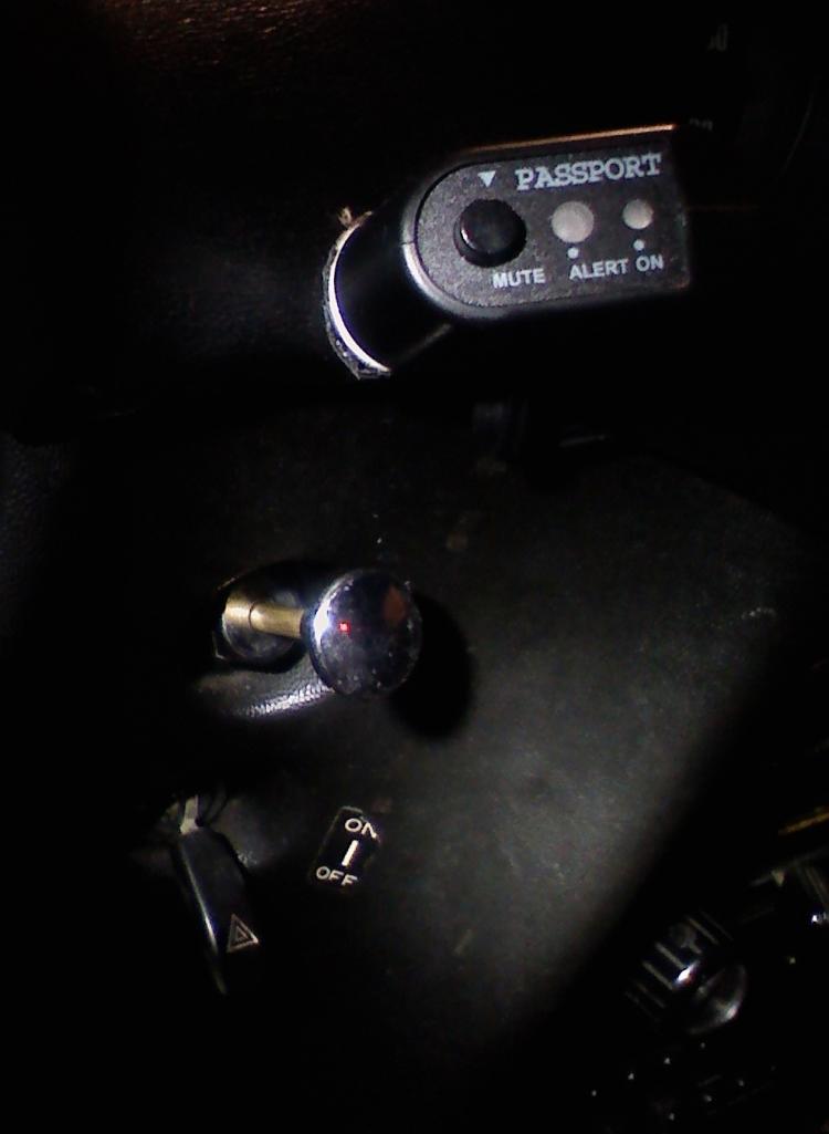

4) A/B switch- position B- it looks like it almost belongs there!
Above the horn switch is the remote annunciator for my radar detector- mounted in the perfect place so I can mute with the touch of one finger, without taking my hands off the wheel.
