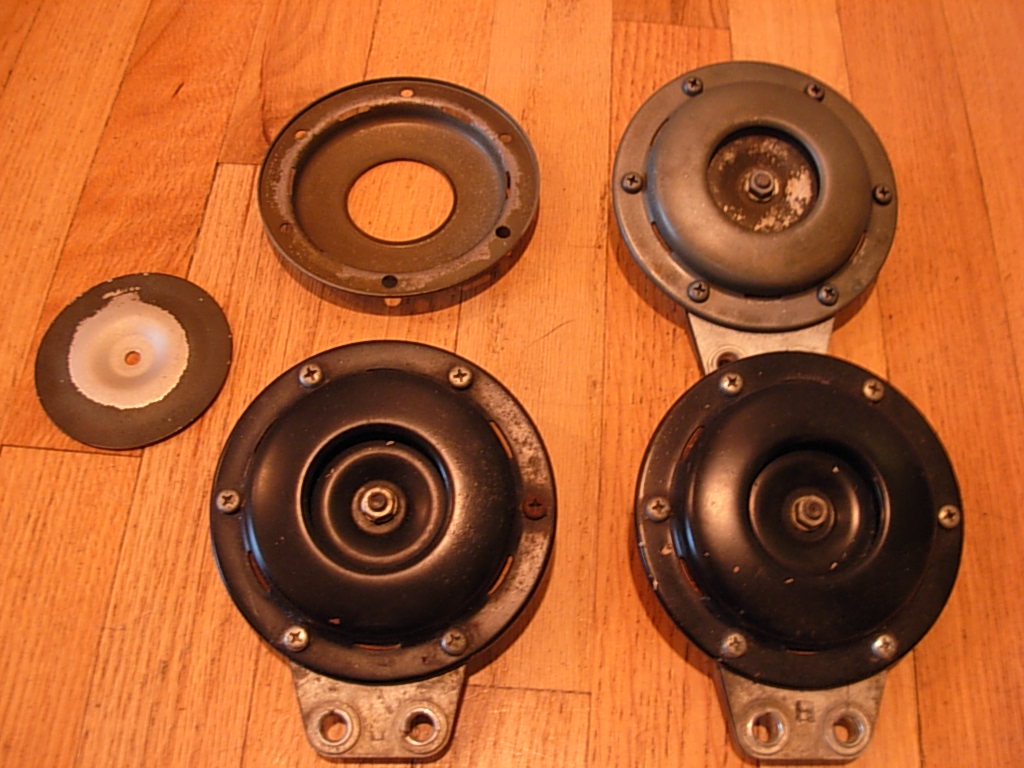

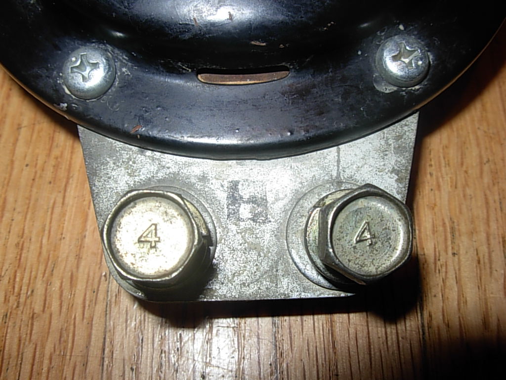

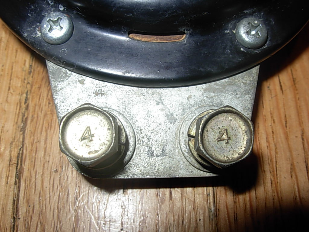

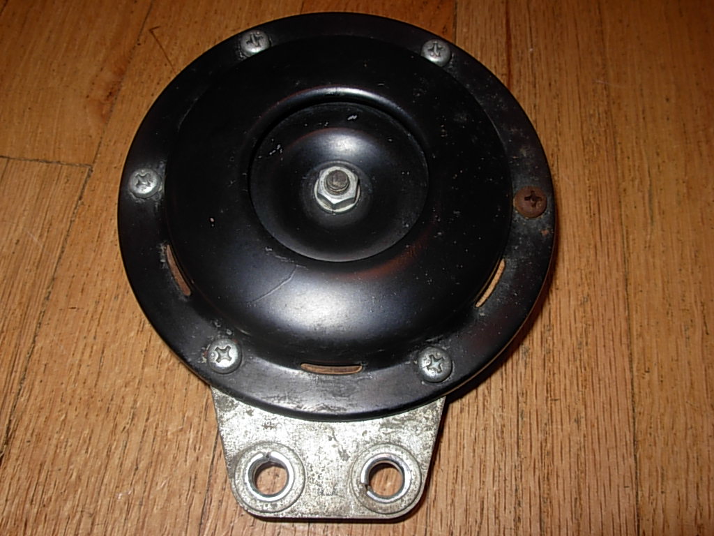

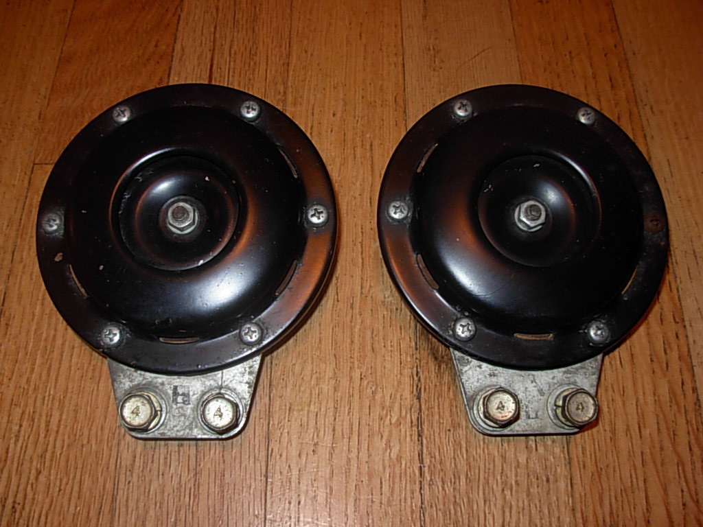

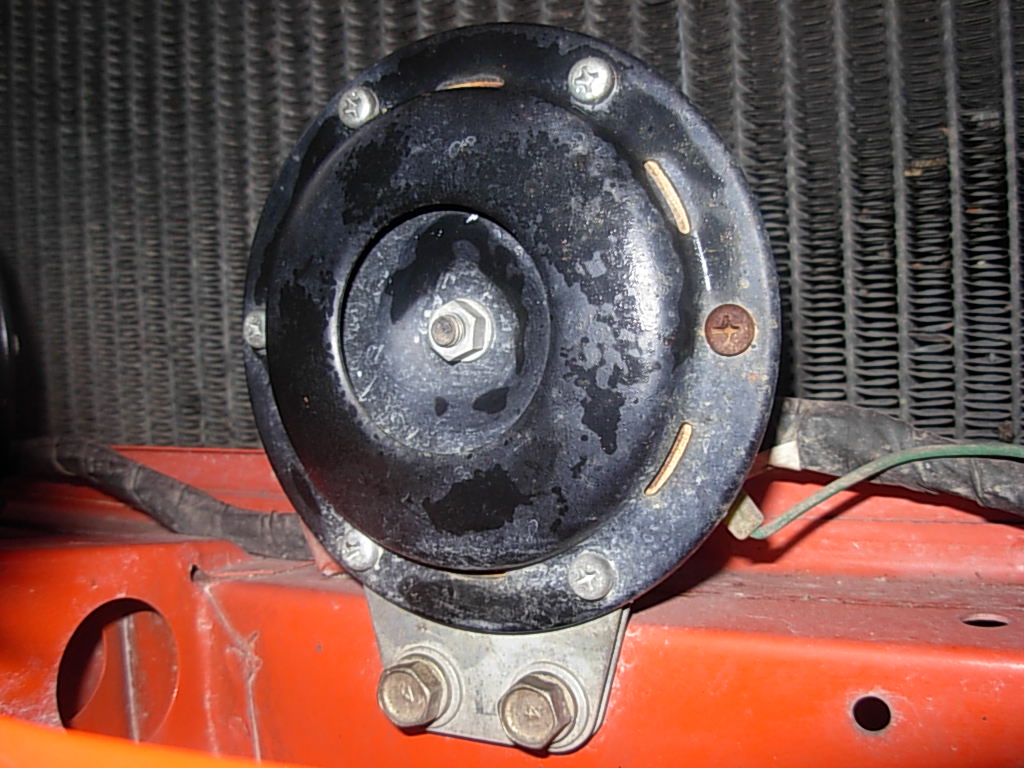

Here are pictures of the original horns from my 1972 240z (manufactured 5/72). The fronts of the horns look like a semi gloss black. I think the rest is zinc plated and the bolts are cad plated. They are stamped H and L on the bottom front for High and Low. The 6/74 USA and Canada parts catalog shows the same part numbers are used up to 7/73.
The horns in HLS30-00032 are not black. They have blue overspray from a repaint, but it looks like they could have been the olive color originally. I'll see if I can clean them up some and take some pictures sometime this week.

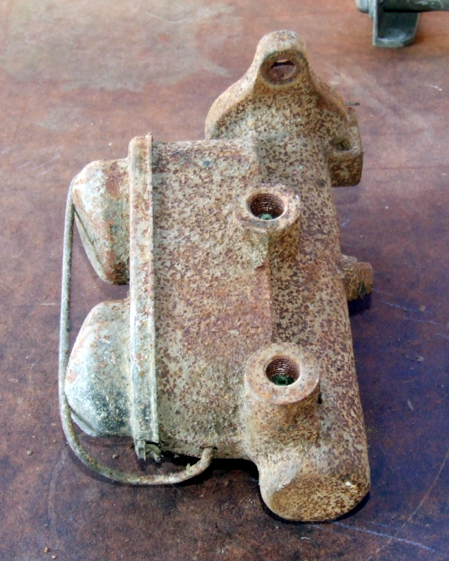

.....I'm still looking for a ratty slave cylinder that I replaced on my '71, but it just won't surface... can't believe that I pitched it, pack rat that I am... I want to show some good before & after results... I found a really ratty looking 280Z brake master that I'll get to soon...

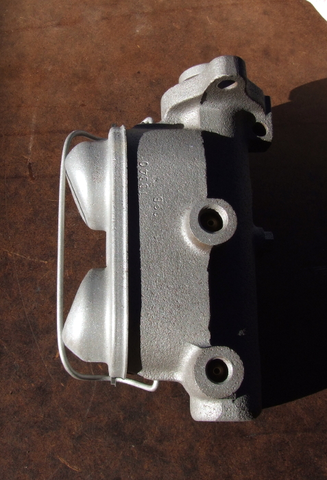

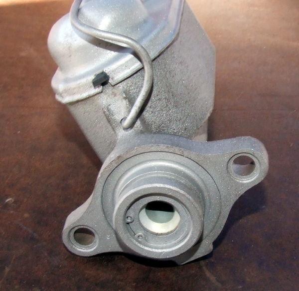

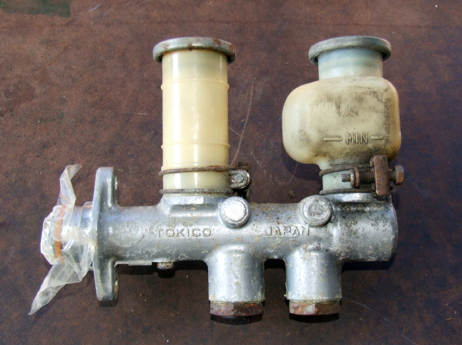

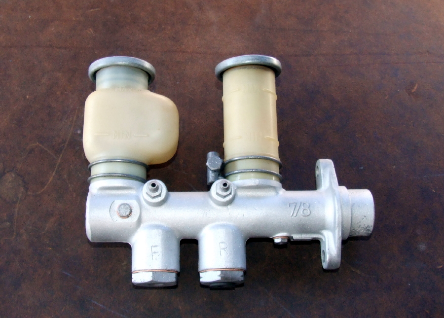

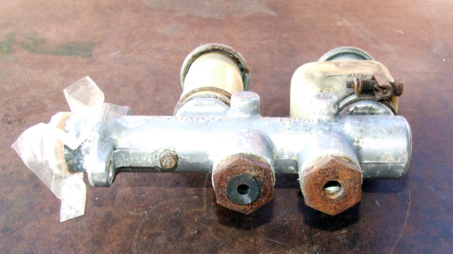

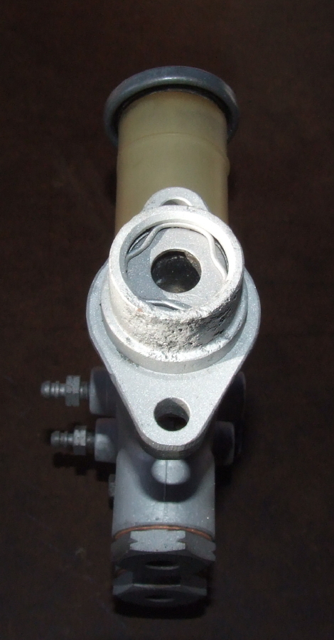

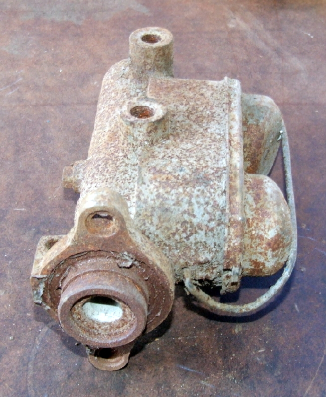

Well, I found the brake master that was turning into a cake of rust.... also found a 240Z master that cried for attention.... and lots of other stuff to experiment with. Here are several before & after pictures that I promised to post. I find the results quite pleasing to the eye.
Comments and/or suggestions are welcome. I'd like to learn more, so feel free. I'm considering making a service available, so comments about that are welcome as well. Thanks, all!
Here are two of the junk master cylinder before cleaning:
...and two after a refreshing:
Another one that was on the 'to be saved for later' shelf....
before:
..after....

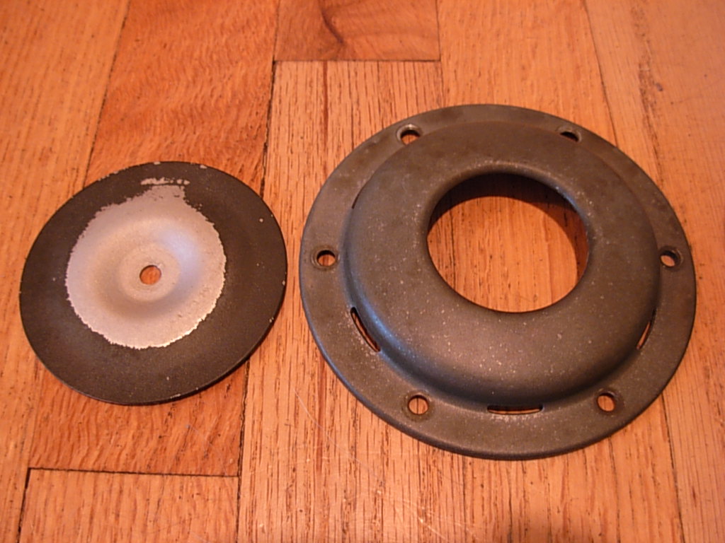

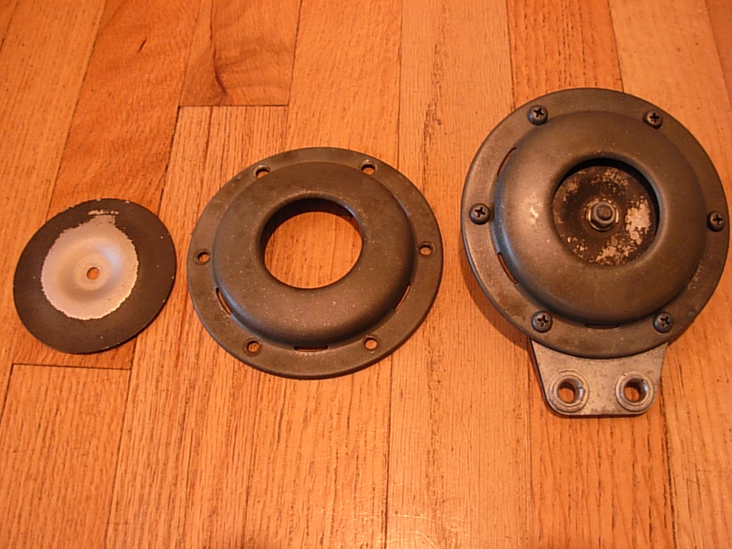

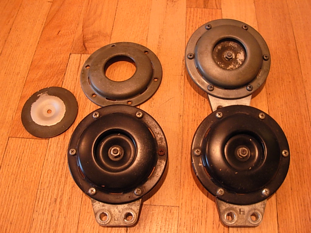

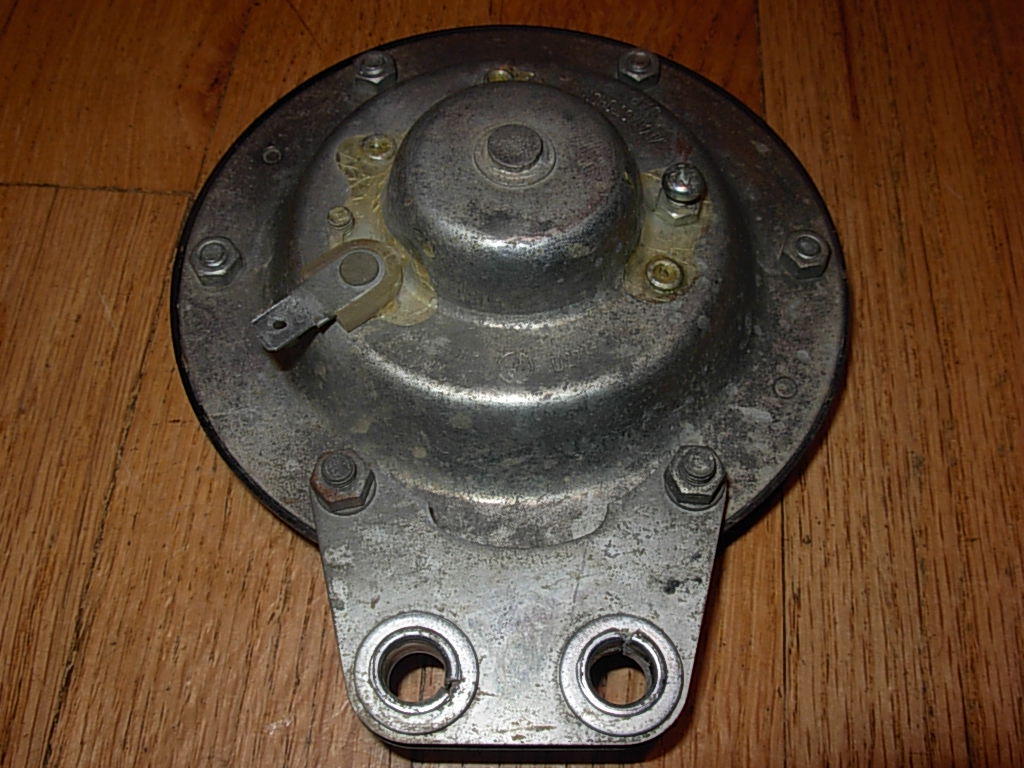

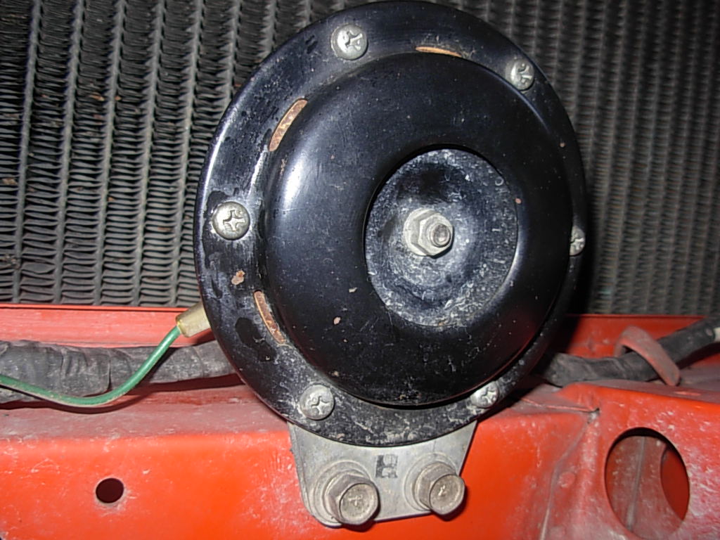

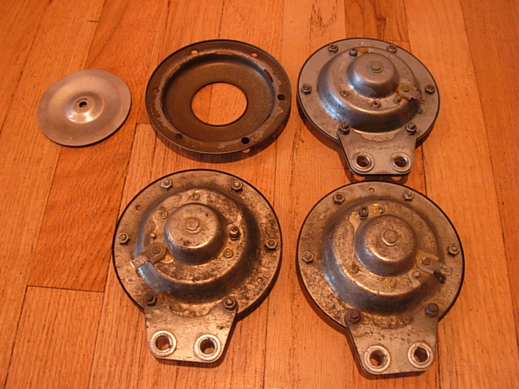

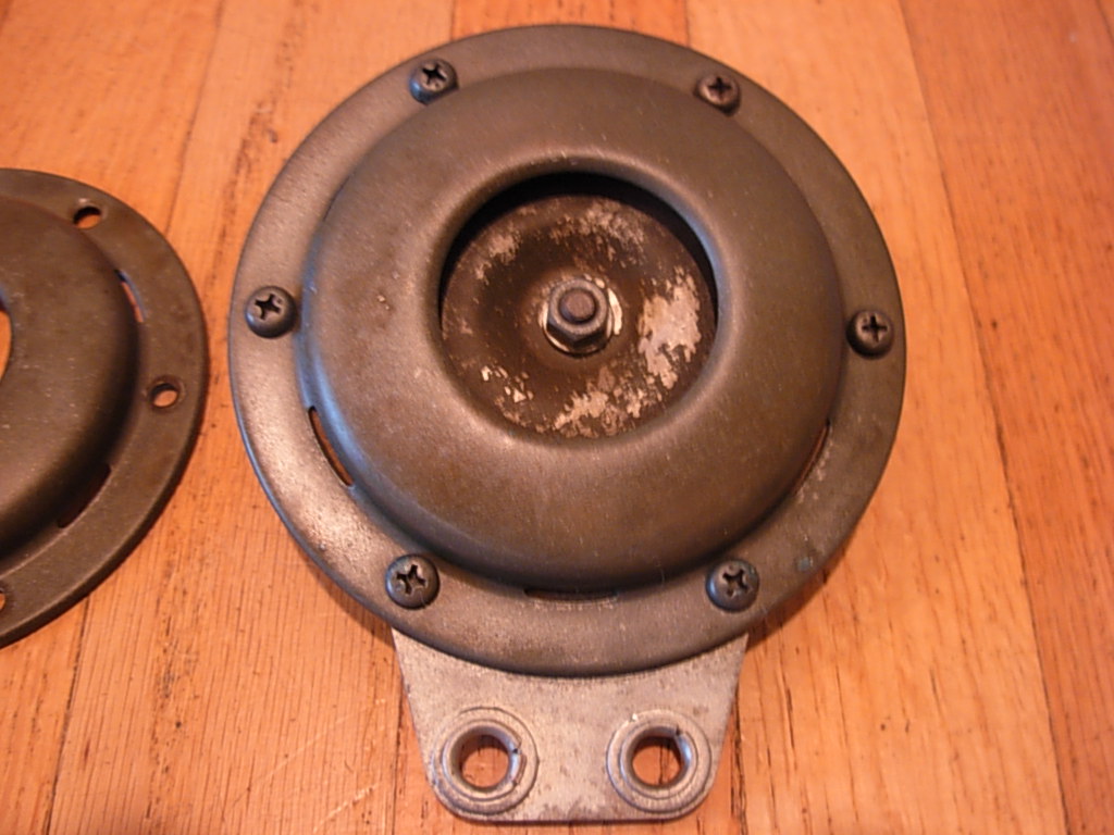

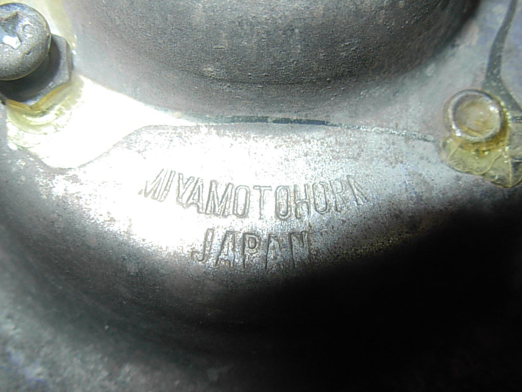

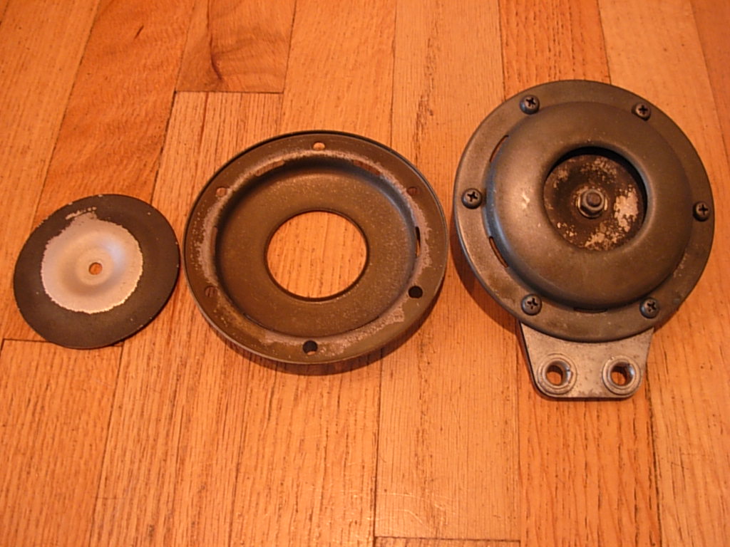

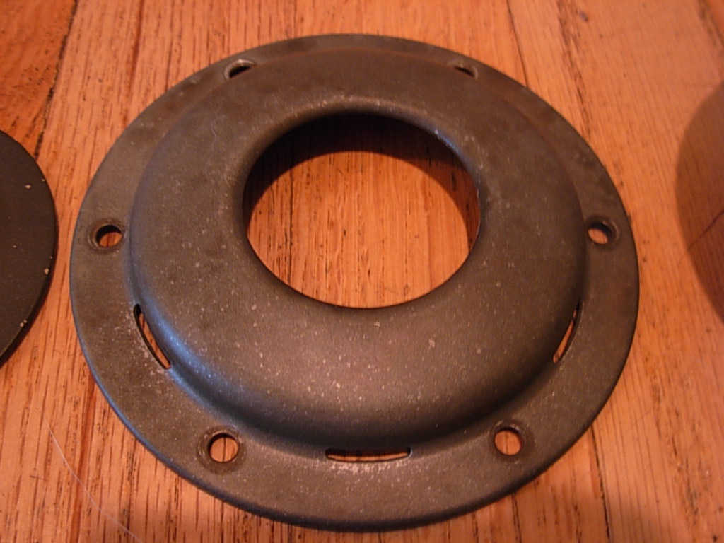

I finally got my own blast cabinet set up today and started blasting a few things. It is addictive. I started blasting the overspray off the horns from HLS30-00032 and then I remembered this old thread about the color of the horns. Once I got the overspray off, I could see that the horns from #32 were originally the olive color that others described. I took one of the horns apart to get a better view of the original paint and some comparison pictures next to the black horns from my 5/72. I think they were originally the darker olive color that you can see on outer edge of the center section and the back of the disassembled horn. The silver color in the middle section is the bare metal where the paint was completely removed. The horns from my 5/72 are definitely original and they are black, not olive.

Nice pictures of #32 horns. I found some olive drab paint to pretty closely match the color of the seat rails and have just painted the fronts of my horns. Boths sets of your horns have been a big help in determining the correct finish for mine. I plan on spraying the backs, mounts, and phillips screws and nuts with a clear satin finish, but I do have one question. In your fifth picture above, it appears that the phillips screw heads are also painted olive on #32's horns. I assumed that they were clear zinc colored like the backs of the horns. And in the next two pictures of #32's front covers, the area around the screw holes looks to be painted olive. If the screws were painted on the horn, wouldn't these screw hole opening have a clear metal ring around them as if blocked by the screw head?
I know, way too anal, but curious minds need to know these things. Great job, Mike B.
