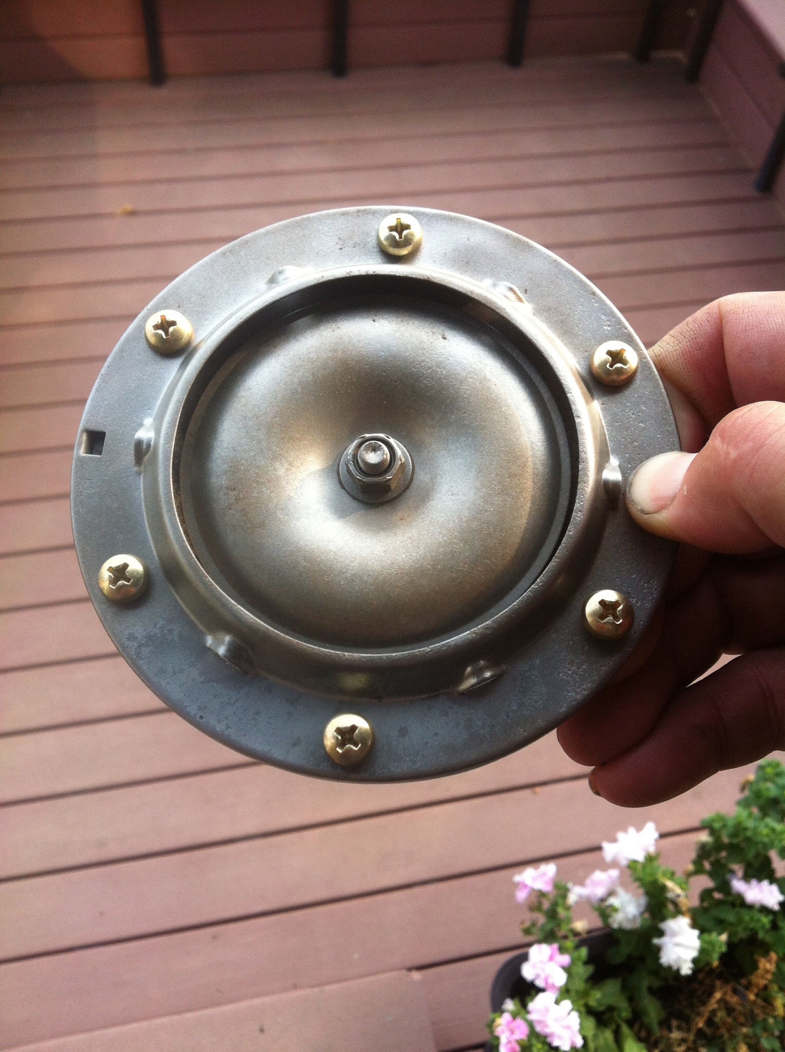

Can anybody add the complete re-assembly of the actual horn unit to this post. It would be a great break-down, restore, and reassembly thread.
Post it if you've got it please.
Not having a soda blaster I used a wire wheel on a bench grinder followed by several applications of naval jelly which got a lot of the rust off and then I painted the horns with primer and then black. Would have painted drab green if I had known that was the original color. Had to have a shop weld on new nuts where the horns originally installed because I couldn't get the horn mounting bolts to go all the way into the rusty bolt holes. PO had removed horns. Lots of anti seize went on the relatively short new bolts to prevent corrosion of the new bolts.

I ordered the same paint code that Dan used (24087), but from a different manufacturer (Gillespie). I found two places that sold it online (Rapco is the place I bought it from). After I painted a set of horns with it, it seemed a little more brown than what was originally on the horns from my 1969 production cars. So I ordered the exact same paint that Dan used (Aervoe) and painted a spare set. That paint seems to be slightly darker green, and a little more glossy than the original paint. Like Dan, I used some steel wool on the darker green horns to make them a little less glossy. I think either paint would be close enough for most people. Here are some comparison pictures with and without flash (it is an overcast Seattle evening here). The Aervoe brand is on the left, the original is in the center, and the Gillespie/Rapco is on the right. I decided to paint the screws and nuts (including the mounting bolts) since that is how they were on my cars.
