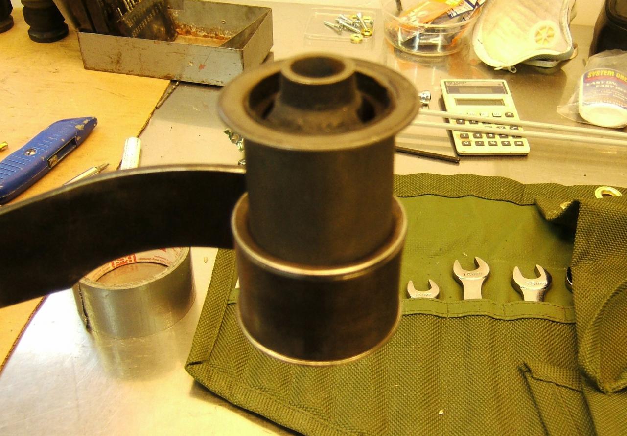

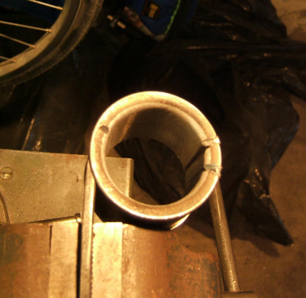

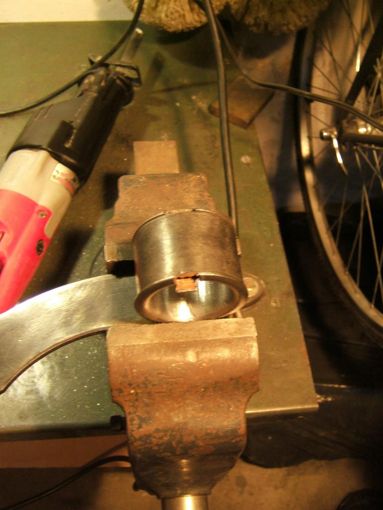

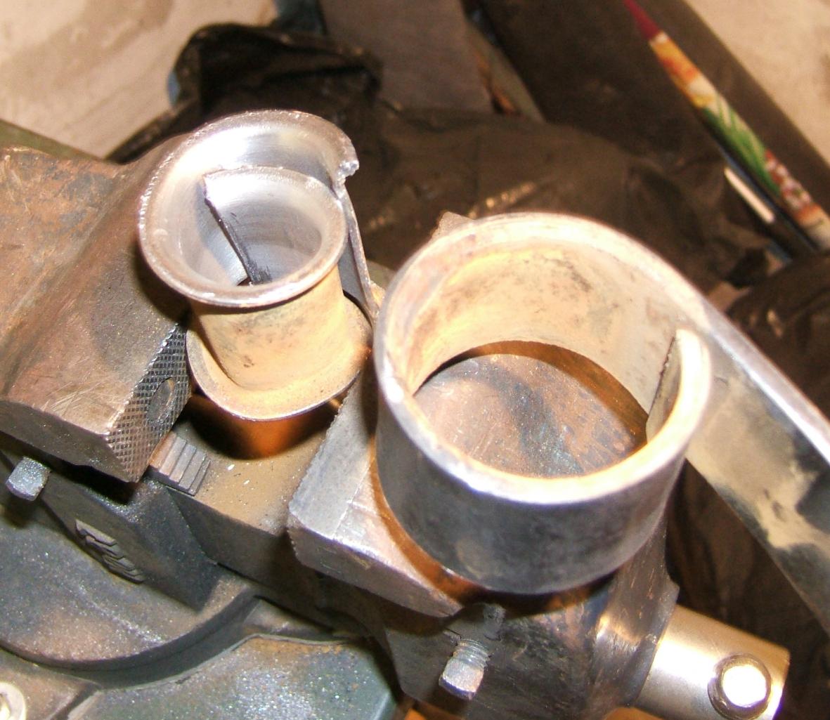

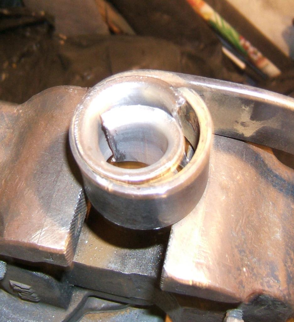

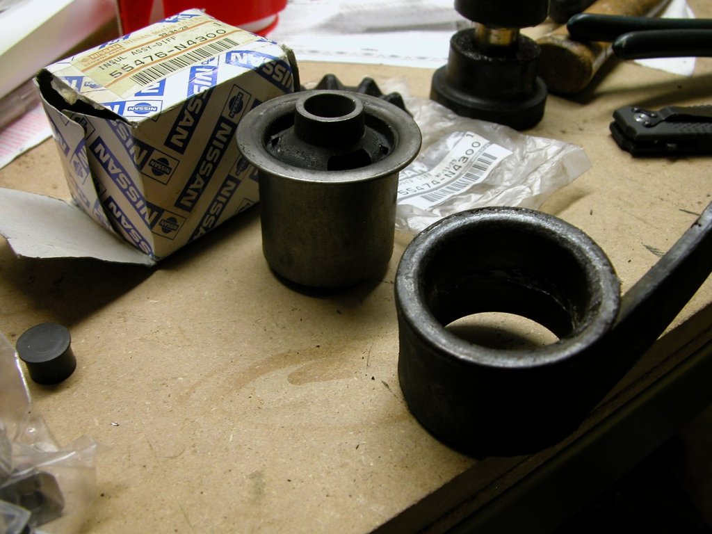

Just to follow up, my Nissan mustache bar bushings arrived today. And as can be seen in the first photo, the new bushing will not fit into the end loop with the old sleeve still in place (the old rubber inserts were removed previously). So, I employed a technique that has been used for removing the spindle pin bushing sleeves. I used a cutting wheel to cut two notches about 1/2 inch apart on the rolled edge (not quite cutting all the way through). Then, after reorienting the bar in the vice, I used a sawzall to make two parallel cuts through the inside of the sleeve, being careful not to cut into the mustache bar loop proper. Next, vice-grips were used to pull down the tang and wiggle out the sectioned piece. Finally, the bench vise was handy for squeezing the sleeve in so that it could be removed.
