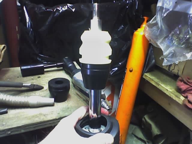

I am replacing the struts in my 240Z
I got some strut boots for a 280Z that I am lookinh to use on the
240. I also obtained some bump stops.
Is the idea of using the bump stop + the 280Z bump stop over-kill ?
See attached jpeg...
zdisease, Jay

Definately overkill. the black one will do the trick fine. If anything using both will cause a bump :) with regular shock travel.
Where did you get the strut boots?
No, not overkill, just bad. On a 240Z with it's lower ride height, doubling bump stops will eat all your suspension travel. Pick one or the other.
I installed bump stops all the way around. With the springs cut and the travel diminished some what , the soft stops still offer a great ride. I will bottom on them on speed bumps if I take them at some speed. However even on uneven roadway the ride is good. These are the only energy suspension parts left . I have been told that this is the brand Nissan is now selling for our cars.
