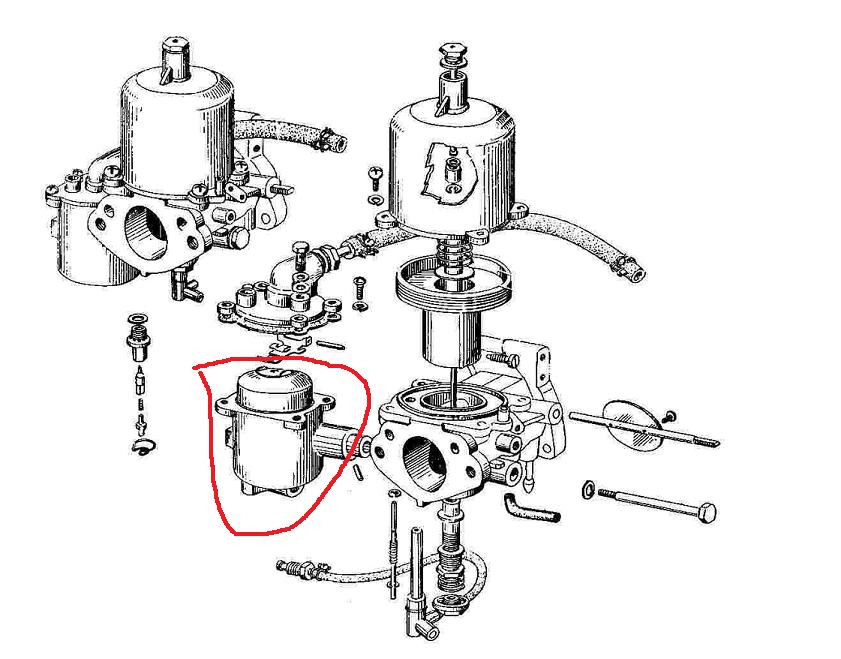

1973 240z with roundtops.....(Thanks Tom) Over the last two weeks I have done the following:
Drained all old gas and blew out the lines, new mechanical fuel pump, new filter, and plugs. Hooked up new intake manifold with the roundtops and attached all hoses, etc. Put 5 gallons of fresh gas back in and went for start up.
Pulled choke and it fired up, ran at a very high idle for about 25 seconds then died. Tried restarting and it hits but wont run. Sprayed some starter fluid and it will start but then dies.
Pulled off the fuel lines to the carbs and turned engine over, fuel spurts out. Whats the next step, anything I should try? I assume it's a fuel issue but everything to my non-mechanical mind look good. Thanks for any help.
Quick edit.....I just pulled off the top of the carbs and noticed the rear carb was dry so I removed this piece..(see picture as I don't know the name, it's circled in Red). When I removed this piece it was dry also so I put a capfull of gas in there. The engine fired right up and ran for almost 2 minutes.....then as I eased the choke in it died, and now it won't even fire with starting fluid. The struggle continues. Also I noticed the coil was very warm, is that normal. I think I'm done for the day, maybe watching football will restore my brain.

The part circled in red is the float bowl. The principle of operation here is quite simple. There's a float in the bowl. It's like the tank on a toilet. When the fuel level in the bowl drops the float drops which opens a needle valve which lets more fuel in. As the fuel rises the float causes the valve to cut of the supply. The net effect of this is to keep a constant level of fuel in the bowl which is then delivered to the carb through the rubber hose at the very bottom.
The fact that your bowl was completely dry indicates a supply problem. I'd first check the other bowl. If it's full then the problem is not with the fuel pump or supply line from the tank, etc., but rather limited to the carb that's empty. The needle valve at the top of the bowl - it's screwed into the lid - can become stuck in the closed position which prevents that bowl from filling up at all.

Yes, sounds like the float valve is stuck closed. Here's a fun test....
remove the float bowl lid completely. Turn it upside down. Attach some flexible tubing to the fuel supply port. While blowing on the tube actuate the float manually and see if the valve opens and lets air through. Float level is determined by the distance between top of the float and underside of the float bowl lid. Adjust the float level by bending/straightening the metal tab attaching the float to the valve.
Check what ID number you have for the carb itself. It should read something like HJG46W something. If it's R8 or R9, rear float level should be around 12mm (1972 rear carb) and front carb should be 16mm. If the last few digits are R3A or R4 (1970-1971), then float level should be set to 14mm.
LOL, dude that's exactly how I did mine the other night, all the while saying to myself "I bet they would at me if they knew I did it this way :D BTW what is the best way to bend the tab w/o messing up the float? I think one of my floats is cocked upwards a bit from being bent (PO, not me). I slid a screwdriver shank under the metal bracket, in between it and the float, so I could bend the tab w/o pushing/ripping the bracket out of the foam float. I set mine by blowing through the hose and seeing where the air flow stopped coming through, since my one float is messed up and set properly is too high.
You guys are good.....It was the float valve.
