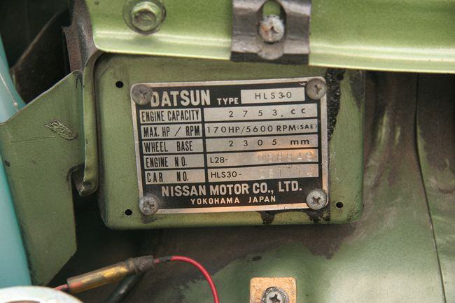

1975 the 280Z came out. Sources speak of the engine having 149 HP. Okay. 1976 some online sources don't speak of anything different with the engine. I have a metal plate under the hood that says 170 HP. I was talking to the owner of one Z shop locally and he was saying "oh yeah we can completely rebuild your engine brand new to 200+HP for xxxx dollars". Another owner of another Z shop laughed and said "there's no way that engine is going to produce 200-220 HP and still be pleasant streetable". I retorted "Oh c'mon, my engine has 170 HP already!" And he replied back "That engine does NOT have 170 HP!"

Then I read on a lot of online sources that in 1977 280Z's HP is upped to 170. I also saw a sticker that still says it has 170 HP, just like mine. Then based on the discussions here and elsewhere, I read that the HP difference between these 280Z cars is non-existent and they're all the same or about the same???!

What I'm curious about, if anyone has a 1975 280Z, is what does your plaque under your hood say regarding your engine's HP?
If Nissan didn't raise power to 170 till 1977, why does it say that on our cars? If they raised it in 1976 then Howstuffworks is wrong, as is another website I visited (don't remember which one).
And if there is a 21HP difference between any of these 280s, WHAT made the difference?
11/75 and the same plate.
