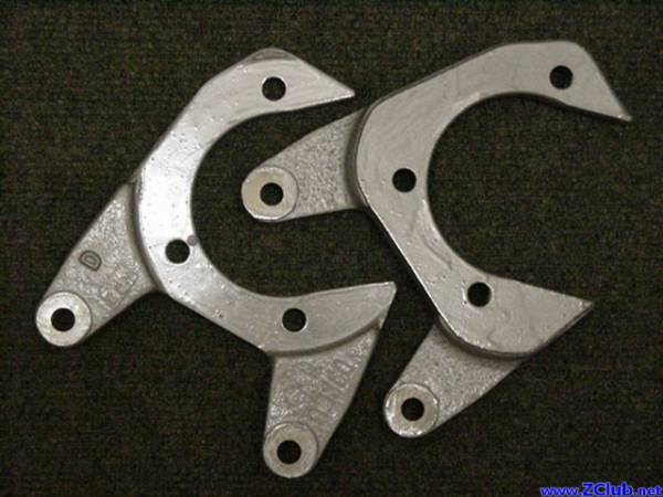

Unless you plan to replace the rear bearings, just cut the drum backing plate off. At a guess you are going to put on the maxima brackets (another reason to pull the hub off). I just cut the maxima bracket (see pic.) so fitting the bracket is easy and no pulling required. The Modern Motorsport brackets for their set-up don't have a "complete circle" around the hub, and with longer bolts (I found the brum back plate bolts too short) it will stay there.

I did consider cutting off the backing plates until I saw how much play there was in the rear axles... Just a bit too much for my liking, so I figure with everything else I'm doing, it's best to at least inspect & repack the rear bearings or replace them. My plan at this point is to replace them. That being the case, it obviates the need for me to cut the plates off. It would have been soo much easier!
