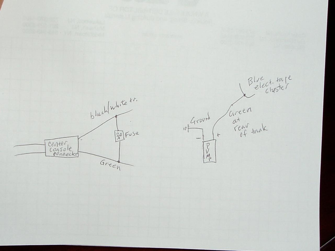

I suppose you know already about the existing wiring. If not, here's the layout:
1) At the driver's side near the defrost panel and left side of the heater bezel is a random-appearing connector secured by blue tape. There's a green wire and a black with white tracer. Jump that with an inline 20amp fuse. This connects the fuel pump to the ignition circuit and (at least on my car) allows the pump to run on Start and Run positions
2) By the gas tank on the passenger side is another butt connector secured by blue tape, attached to the branch of the wiring harness near the fuel gauge sending unit wires. Green is hot, black is ground (already grounded near the rear of the body.
I connected my pump to the rear suspension piece as depicted below.

1) "there's a green wire and a black with a white tracer"... do you mean basically, connect them together with a fuse in between, at the console area?. does that 'jumped' connection then travel to the 'green' wire in the rear of car as described in your # 2). basically, so as not to have to run a solo (+) wire from the console to the rear underside of the car.
pardon my interpretation, but that's how i read it :o)
i'm also a tad custy with the hand drawn schematic depicting inertia switch and relay.....not sure i follow that one...

Yup...the green is power/hot from the fuel pump. The black with white trace connects to the fuseblock and subsequently to the ignition circuit. See the 1973 FSM section BE-6, or see if someone can link a copy of the wiring diagram.

That looks right to me. The black wire at the rear engine harness runs to a ground along the rear "frame rail" near the rear valance and gas tank. Tough to reach with the tank in place, but if you can it may be helpful to unscrew that ground, sand off the rust and reset the ground screw. I see no reason why you couldn't ground the pump separately, so that may be an option if the wiring looks suspicious.
