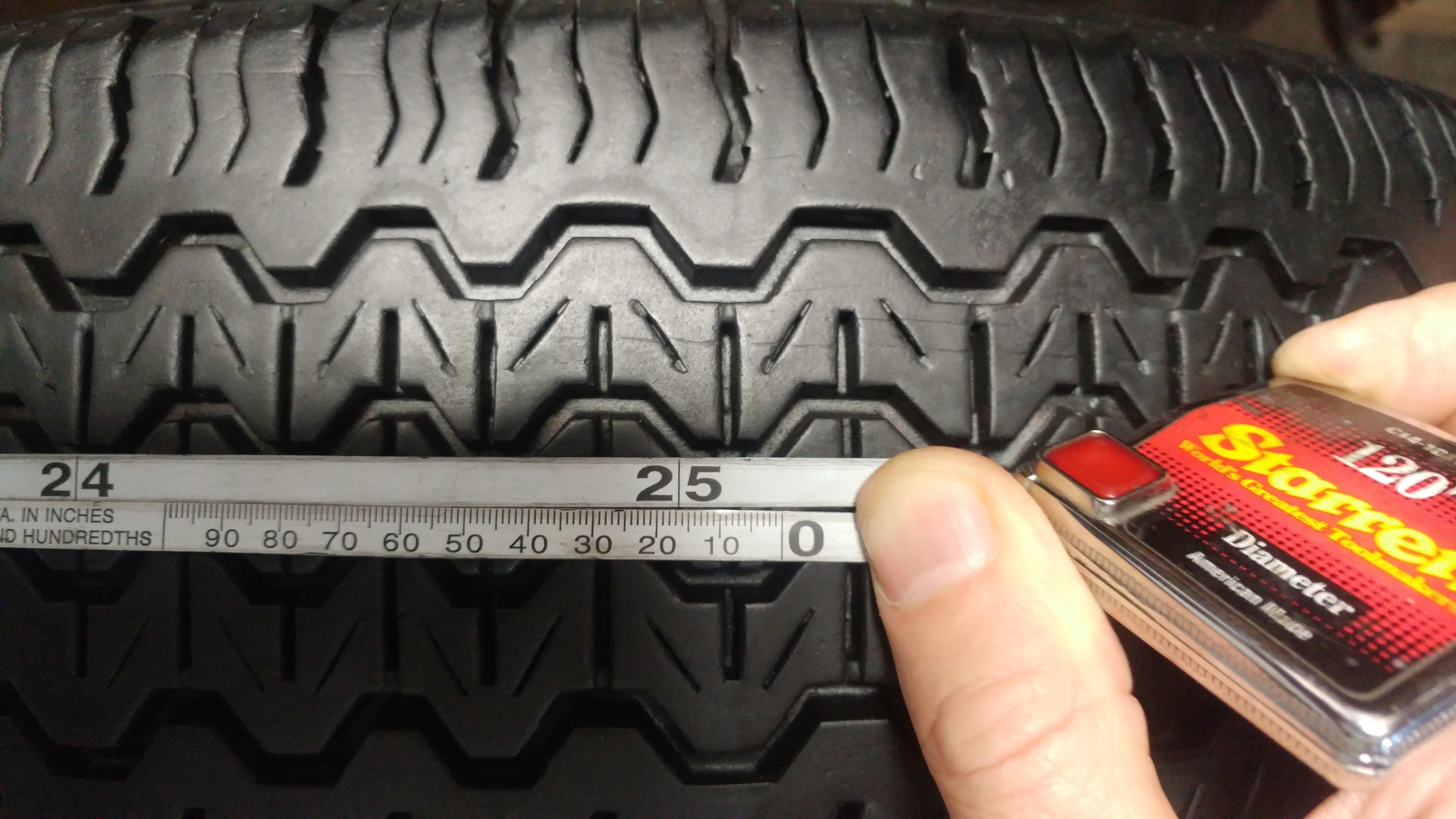

I found 175 HR 14s for sale: https://www.longstonetyres.co.uk/175hr14-michelin-xas.html
These are 634mm, which makes the ratio for the sidewall 79.542857142%
So Arne was right according to this tire.
Edited by Matthew Abate

Matthew many thanks for thr research thats one of the best charts ive seen concerning side dia. FWIW I have 185/70'S on shelby cal 500's i dont like them sidewall too short but came on the car when i bought it an are still like new so once they wear ill go to a different size  i like the look of the 70's tires tall side walls
Using a set of Falken / Ziex a size smaller than stock.  Car sits a little lower due to the tires. 130 MPH speed rating, good in the rain. Tires with a high speed rating wear out a little faster, seems like a bad gamble to go with lower speed rating though. I went smaller to get a faster time at the strip, although I haven't raced it since installing them. Feels a lot faster off the line and 40 to 90 MPH for freeway on ramps. Speedo optimistic per table, but I don't care.
Bigger motor now so maybe I'd get a quicker ET and/or faster top speed in 1/4 mile by going back to stock diameter, don't know though, lots of variables. Guess that's a question for a different thread.  Main thing is get good tires. H rating or above. Bought some Enterprise cheapies when  was broke. Scary in the rain, also one blew out on the freeway. It was fairly new.
Matthew, thanks for producing that awesome chart, it is very useful.  For reference I just measured the lightly used original spare from my 7'70 car, its a Bridgestone 175SR14.  Using a Pi tape I measured the existing outside diameter at 25.17" and a tread depth of 7/32".  Calculates to just over an 81% aspect ratio, right in the middle of that 80 - 82 range.
Cheers
Mike
