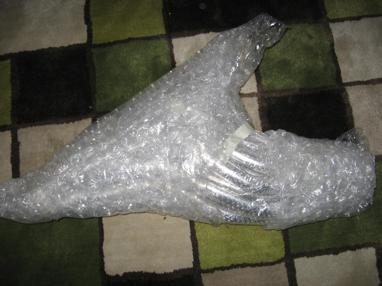

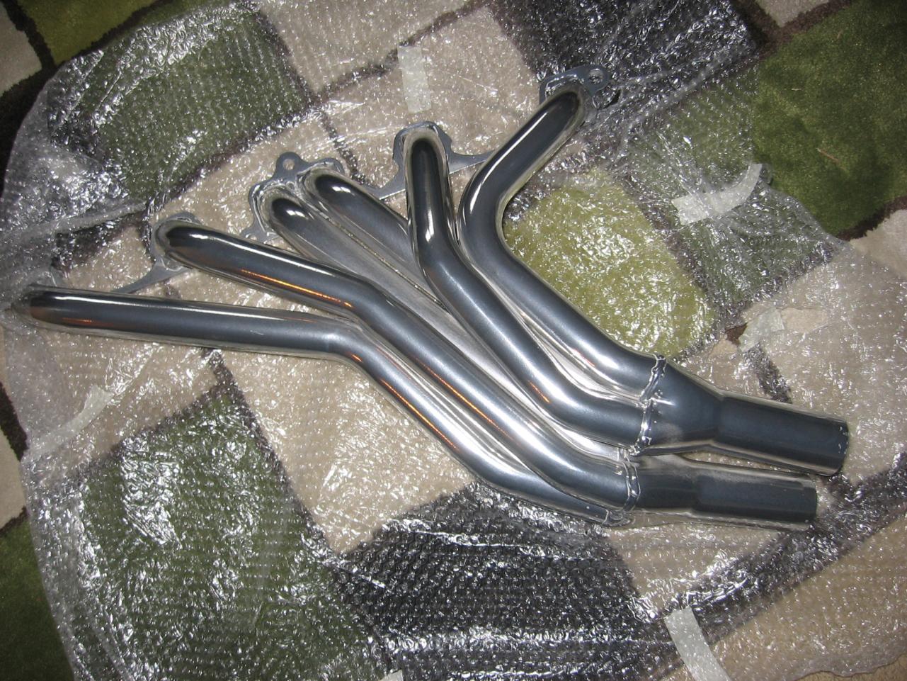

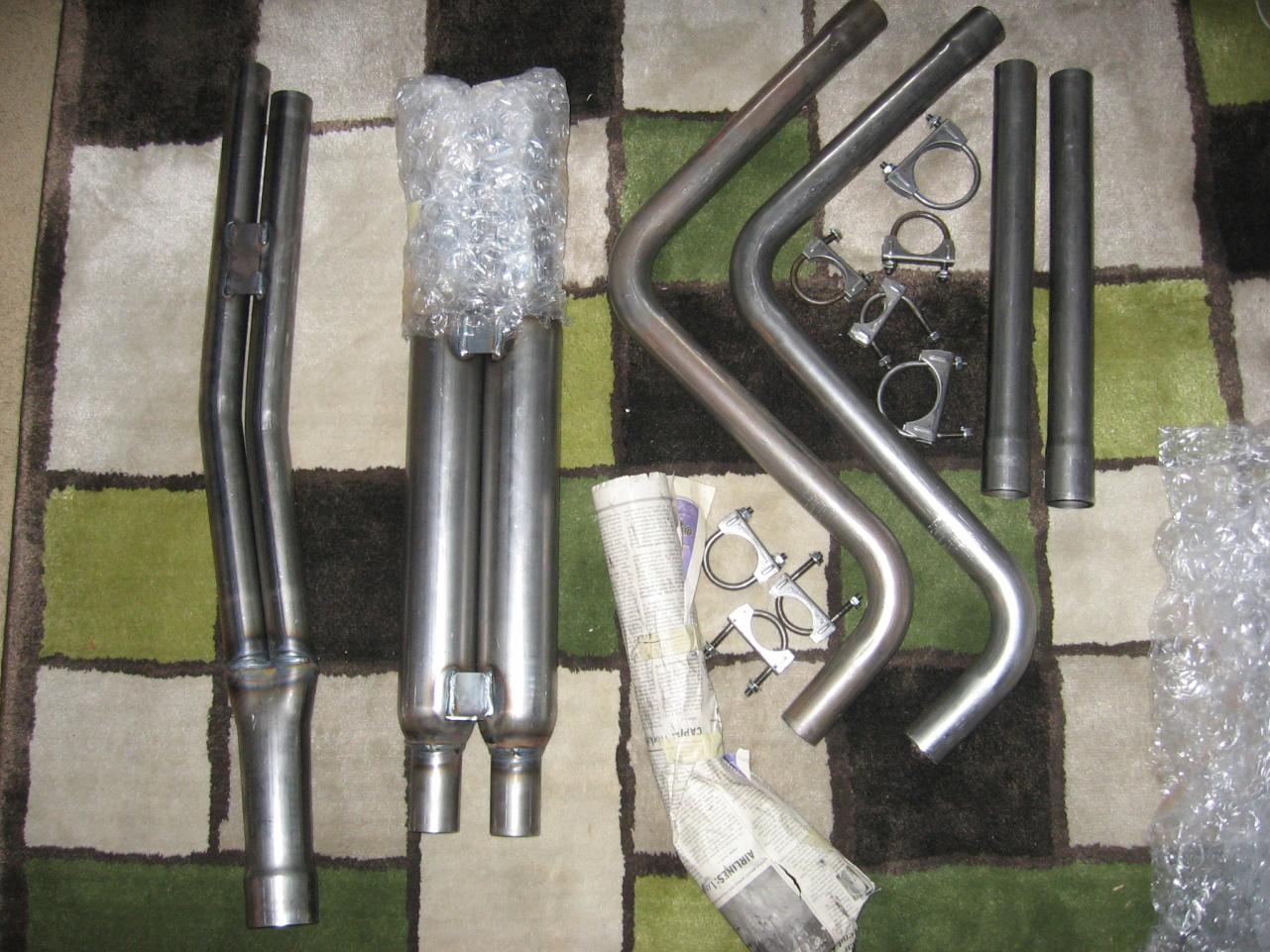

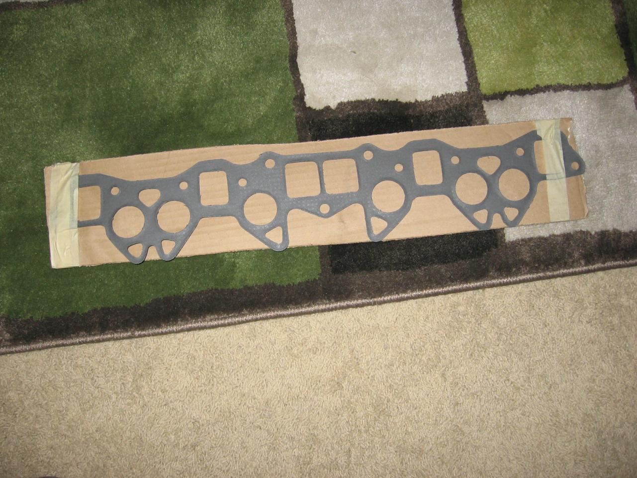

FedEx guy just dropped off the parts! He came yesterday morning, but I was in class.
So now, just like I promised, here are the unboxing pics.
The headers look great! And I can't wait to hear how those pipes sound.
