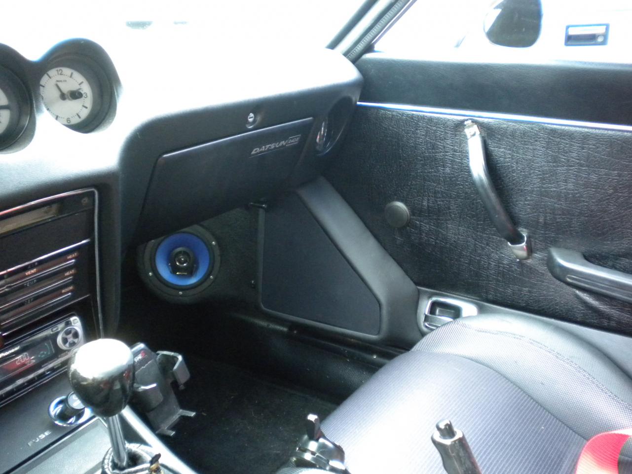

Are the Boston Acoustic 4" speakers you installed two-way? If so, did you have any issues with reinstalling the 1/4 window and dog leg trim?
Yes, they are S45 two-ways. They are virtually flush, so they do fit behind the factory trim panels. I started with different speakers that were SUPPOSED to be flush and they were no where close. I had to send them back. Before I bought them, I specifically asked the Crutchfield sales guy if they protruded past the main cone and he said they'd fit fine. Luckily, they shipped the Bostons immediately rather than making me send the others back first. :beer:

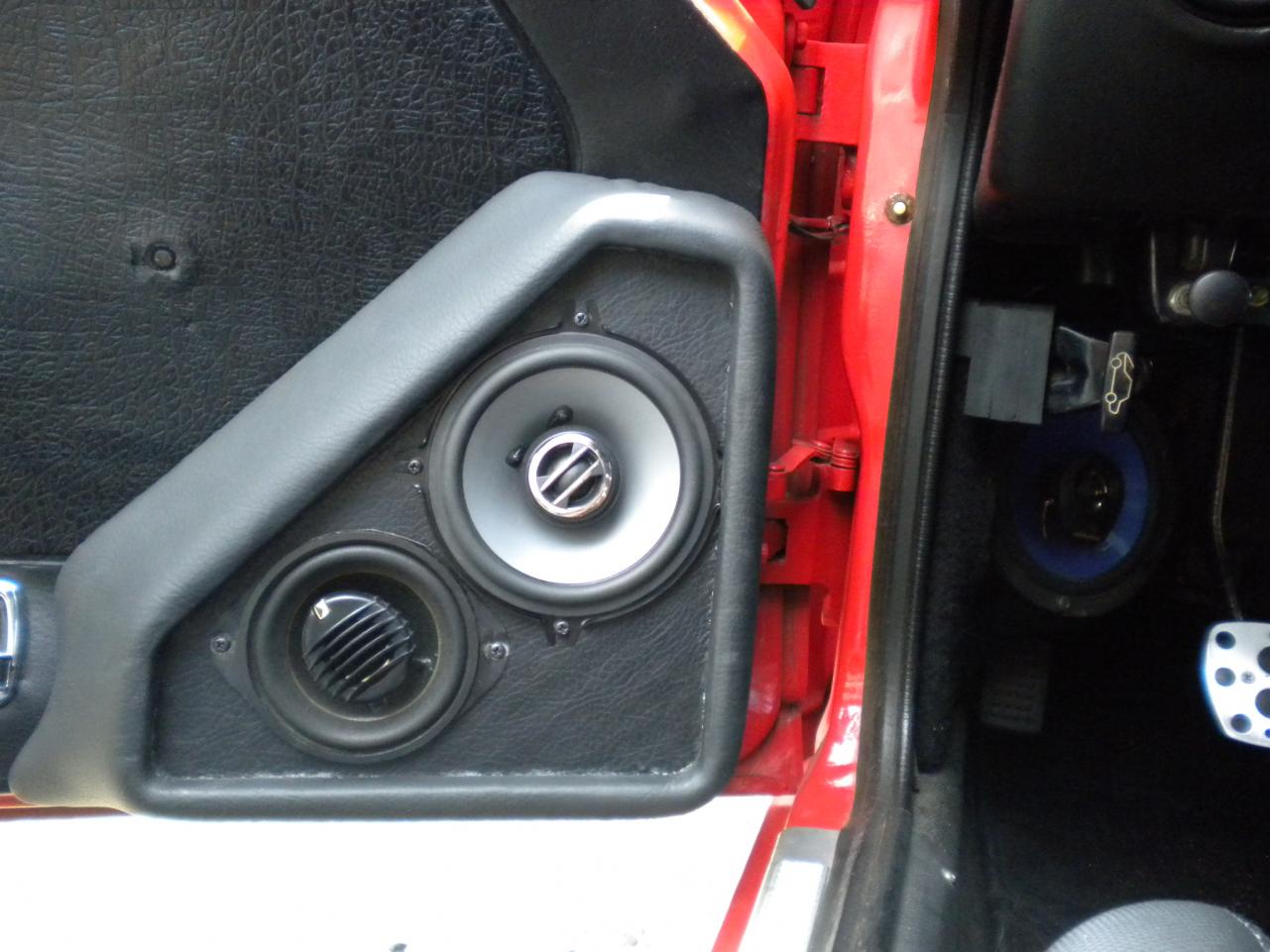

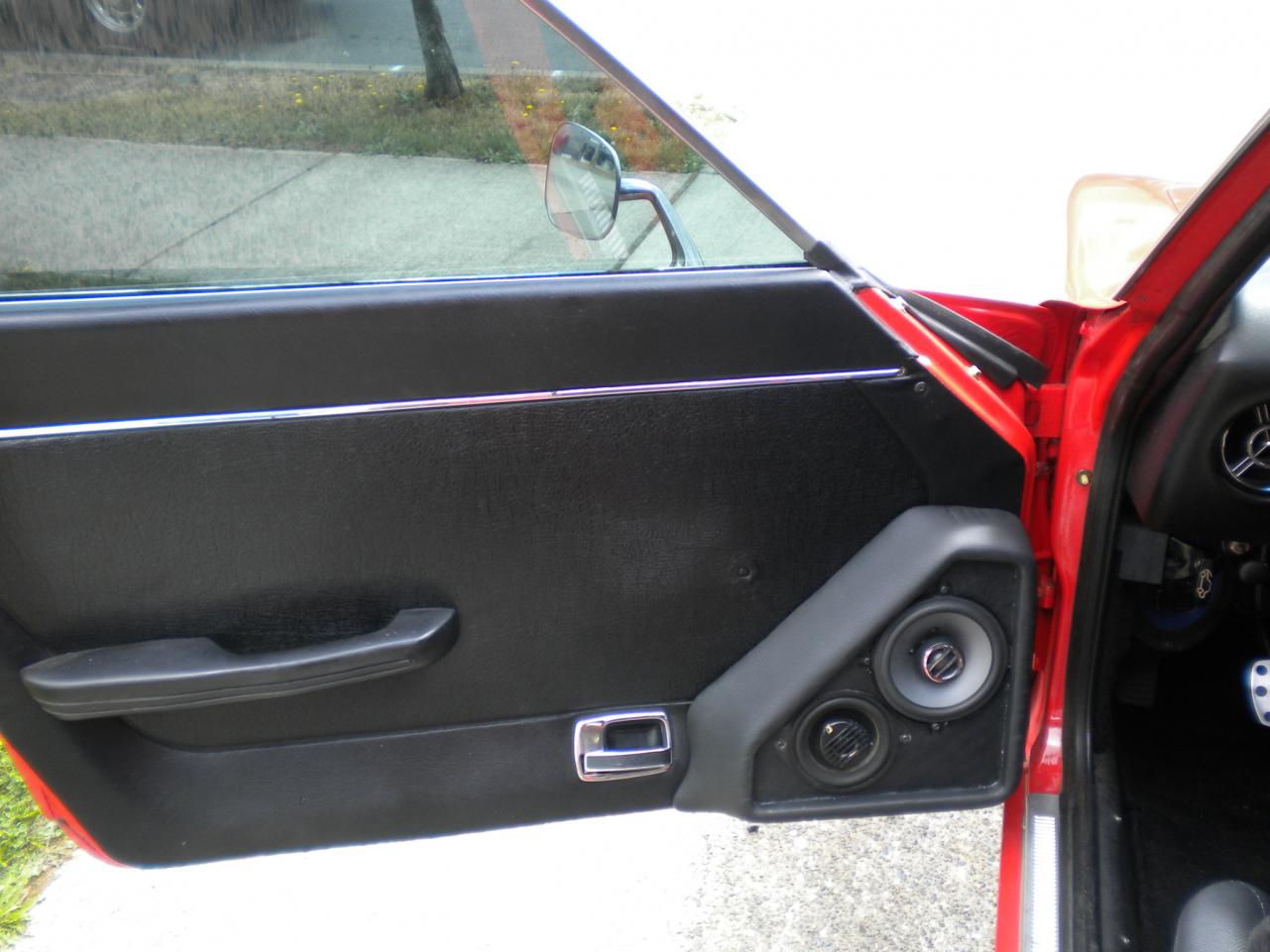

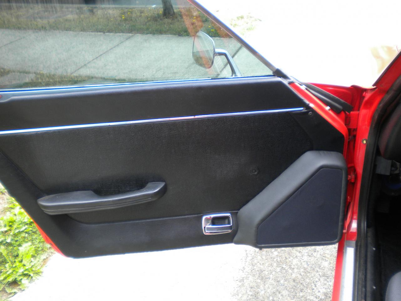

So I finally added some Door pods for the Multiplying speakers in the 70'. There are 2) Apline SPS-500 5-1/4" 2-ways and 2) Kicker 400 4" 2-ways. One of each in each pod. The fit snug on the doors and under the dsh when the door closes. The sounds is incredible. And as big as they look, they don't interfere with any thing, legs, room, whatever.
So these, and the 2) Apline 6-1/2" 2-ways in the kick panel pods make 6 speakers up front and 2 in the rear make for 8 speakers, along with the 2) 10" subs in the rear.
